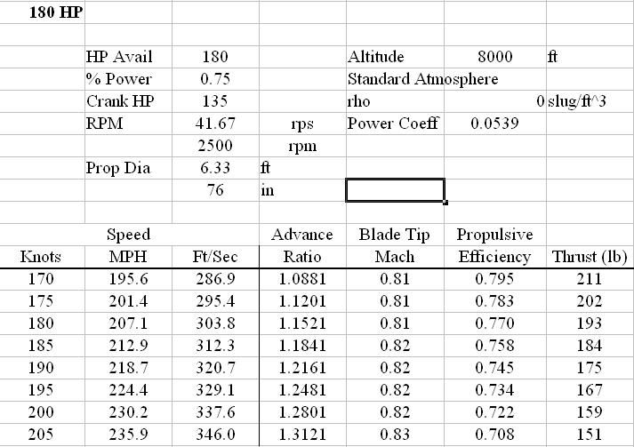

Default F7666 Performance, hard numbers
I have Hartzell factory supplied (*theoretical*) data for the HC-C2YK/F7666-2 and -4. I don't have time to calculate the F7666's efficiency for Vans flight condition, but its in the 78% or better range.
Very good, George. You're spot-on with that comment, but above about 202 mph, we don't even get 78% out of this prop. And these numbers don't account for fuselage blockage effects.
I got engineering data from Hartzell back in 1999, and distilled it in my own spreadsheet:
F7666A Propulsive Data, 180HP, 75%, 8000MSL
As you can see, the F7666 doesn't even break 80% above 195 mph at typical operating RPM of 2500 and 8000MSL. It gets worse at higher RPM. I was surprised to see such poor numbers - made me wonder if we've been using the wrong prop on the RV's all these years. Its not too hard to find better performance (80-85%) elsewhere. The Hartzell BA section is better, but I don't have data for it (yet).

Originally Posted by elippse View Post
So going from 2500 rpm to 2700 rpm should result in 8% more power which should give about 2.6% more speed, as from 190 mph to 195 mph.
Don't forget you lose propulsive efficiency when increasing from 2500 to 2700 RPM. That's a big factor.
