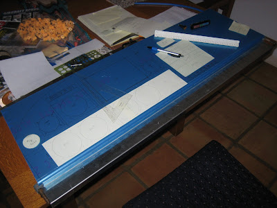

Project 1 : I have Louise?s blank instrument panel on the dining room table, with drafting equipment, templates and avionics manuals (plus the occasional switch and circuit breaker for size reference) spread all over. This is an on-going design project which attracts my attention as I drift through the room - I like to think of it as a jigsaw puzzle where I solve a piece every time I walk by?.getting close now - only a few things left to decide on!

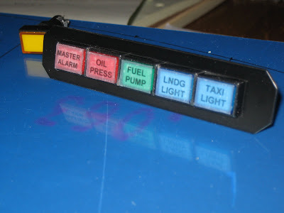

Project 2: Louise?s new panel needs an annunciator! So I scraped together my raw materials and began building one similar to what I have in the Val - only better this time! Part way through the build I needed some new LED?s, so I swung by the Electronics Parts Store (the candy shop, so to speak) and while there I was transfixed by a couple of bins of brand new (surplus) square indicator lights, LED-illuminated, already set up for 12 volts?.for an INSANE price. I filled a basket with them for future projects, and headed home with the booty. Annunciator Panel ?Mark II? will be unveiled soon. (By insanely priced, I mean it was cheaper than buying an LED and dropping resistor alone?)

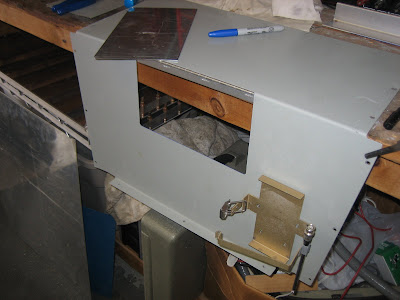

Project 3: Danny King, I hate you?.why?d I have to look in the rear baggage area of the Doll this weekend? There goes another few hours?.What a great idea - an access door in the hat shelf to get to the rear mounted battery. Granted, I don?t really need it that often - I have an external power jack if I need a jump, or to power the airplane for avionics maintenance - but what a great way to check the elevator bell crank without taking out all those screws! So now my shop is once again filled with aluminum dust and slivers, the rear baggage shelf is on the operating table, and I am halfway done. I would have finished it except that all my silver clecoes are at the airport (or turning into coat hangers in the closet), and I didn?t discover that fact until I was home for the evening. But the metal cutting is going well?
Is it a national brand? Can you relay part number or manufacturer of said insane LED lights. Thanks. Happy T-day.

Craig,
The place I foudn them is a one-of-a-kind Electornics store here locally, not a chain. They have a combination of new, new surplus, and used equipment and parts, and most everythgin is bulk, so it can be hard to identify. These little thingsare simply labelled "Indicator - 12VDC", and have a logo on the decal that is a diamond with NEWLT in it - I did a quick google search, and didn't find them, but probably didn't look long enough. They were $0.95 a piece.....

Hi Paul
Those square indicator lights are off FANUC type CNC controllers. They are made of unatainum in the Reno area. Could you please post the name and address of the place you bought them from. I would like to make a annunciator panel for my panel upgrade

The name of the place is Electronics Parts Outlet (EPO) in Webster, TX.
