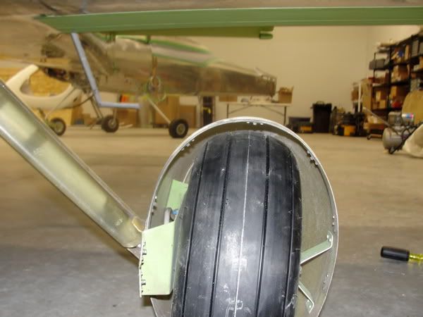

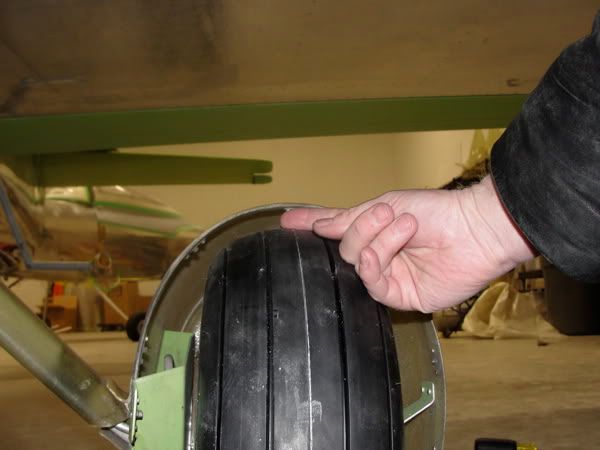

Just thought I would show some pictures on the best big tire thread. I did not have to change the mounting of the wheel pants, just trimmed them, mostly on the sides and the back.

Hans thanks for your pictures. That helped answer a couple of questions. Cutting out the bottom isn't much of a problem. Moving the mounting brackets was more work then I wanted to do. "Big" tires on order.
