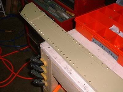

Thanks guys for the good but conflicting advise . I was off at work using the paint booth, priming up my wing ribs. I'm glad that's done. I will talk to Vans tomorrow and let everyone know what they say.
Originally Posted by dan View Post
I agree with Dave. I'll bet Van's will tell you the spar itself is fine, but that the doublers need to be replaced.
While you're at it, it will be a good excuse to flip those rivets around. Rule of thumb: Shop head on the THICKER material side whenever possible.
Dan,
Thanks for the heads up on the rivet shop heads. I will definitely remember it. Did you end up drilling out your rivets in the rear wing spar? I notice on your web site, http://www.rvproject.com/20020512.html, it looks like you put the shop head the same way I did. If you left them the same way and are up and flying, I'm comfortable leaving the the rivets in the rear spar the way they are if Vans says I don't have to replace anything.

Vans replied and its only half bad .
"Only partial bad news on the rear spar. Engineering wants the doublers, W-
707G and D to be replaced. The spar is OK. Be careful; drilling out the
rivets or you may have to replace the spar also.
As a reminder, do not drill though the rivet. Drill just through the head and
then pop it off with a prying action with a tight fitting punch or the shank of a
drill. Then punch out the rivet shank or pull it out using a side cutter to grab
it tight. That way the hole is not compromised.
Counting the ribs from the root (as number one), towards the tip, on the
second and third rib, ignore the extra holes in the spar web. On the fourth
rib, put two blind rivets (LP4-3) in the extra holes in the web."
I'll probably have to get a spar because I bet I'll screw up drilling out the rivets.

I would like to report after an hour of drilling and popping out the rivets head, I successfully removed everything and don't need to get a new rear spar also . My replacement cost is about $21.00 and I might as well get a few extra thing to save on shipping (Ductworth 100 Watt lamps and some 3/8" aluminum tubing).
I also got a reply about which way to put the shop head and Vans response.
"Shop head/manufactured head orientation is not important. It's up to you."
Guess I'm going to have both wings with different orientations since I'm leaving the right rear spar alone. Thanks guys for all your help.
