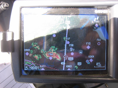

With nothing to do but check weather and watch the autopilot fly, I took a couple of pictures as a passed a cell northeast of Dallas. Here's what it looked like on the 396. Sorry for the glare - note the cell off the left wing with lightning, and the small cell without lightning of the nose.

Nice photos! I have really found it educational to see a cell on XM and visually at the same time - the eyeball and radar / stormscope sometimes give different assessments of the same weather, and it's good to "calibrate" the eye. Glad to see that XM is "telling the truth" about what's really there.
