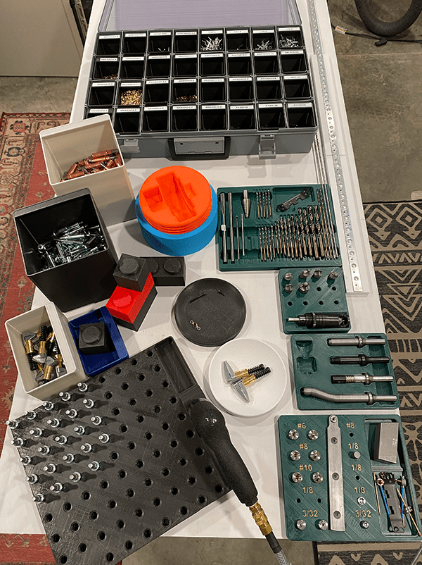

Long-time lurker, first time poster. Firstly, thanks to this amazing community for the near-infinite amount of knowledge (I won't dwell on that point too long, you all already know you're awesome).
I'm a new-builder, received my empennage in late May and have been slowly building ever since. Along the way, I've designed a few different things to help with my build: Cleco stands and trays, storage bins, rivet set holders, trailing edge wedge jigs, etc. The picture below is of (almost) all of the things that I've designed and printed for my build so far, and I thought who better to share this with than the Van's builder community! If you're interested, I have a detailed blog post on all of the parts here: https://www.jeraero.com/2021/08/13/3d-printed-tools-initial-backlog/. And if you just want to go directly to the STLs, here's where they're hosted: https://thangs.com/jwilliams2020/JerAero-RV10-Assembly-Tools-23840
Most of the prints:
p.s. Advance apologies if you thought this was the ever-fabled complete set of 3D plans for the RV-10, alas, I haven't discovered those yet - if someone has, please let met know (I've been flirting with the idea of measuring and recreating each part in CAD as I build, but I fear that's going to add another year or two to the build)
That is awesome!!! As a just starting builder, waiting on kits and organizing my shop, this will likely push me over the edge to buy a 3D printer.
Thanks for posting this!
Do it!
That’s awesome Phil, I’d say go for it (buying a 3d printer), they’ve come a long way over the past few years and even the budget-friendly Enders are pretty solid out of the box, especially when printing PLA. I suspect you’ll find many uses for it (I know I have, even just around organization), it’s amazing the difference a custom-sized storage container will make.

I really like what you’ve done here. PM also sent.
Very cool. Thanks for sharing! I will definitely be printing some of these out. Thanks for the blog as well. Seems to be high quality with some great information.

Awesome job. I bought a semi-build tail and wing from another builder and start organizing my shop. I started out drawing out some cut outs to laser cut organizing trays for bits and squeezer sets. I will use some of your designs to 3d print. Thanks for sharing.

I was looking on thangs, all I see is your cleco organizer part. I’m definitely interested in printing up some organization! Im only printing with a lowly ended 3, but it’s not a bad little machine. Definitely worth its price for the fun of dabbling in printing 3D.
I uploaded all of the parts on Thangs as a multi-part submission, to see all of the parts, click into the part navigator at the lower right (shown in my screenshot). If you don't see the navigator, just click where the 'x' is shown in the lower right of my screenshot (it'll be a ^), and that will expand the part navigator for you.
Alternatively, you can always just click 'download all' and you'll get all of the STL files too.
Also, the Ender3 is a solid machine, it'll be able to print just about everything I uploaded except for the cleco holder (the cleco holder is probably too large for the build plate on the Ender3). Give a shout if you were interested in printing that part and I can probably slice it down a bit to fit a 250mm buildplate.

Jeremy, this is very cool. I don't have a 3D printer, but one of my sons does and he's made your rivet tool set tray and drill bit trays - very nice. Thank you for posting and sharing your innovations.
This is pretty neat. I gotta find someone with a 3D printer, the Online companies wanted around $900 bucks to print a few of theses. Crazy!
Mike- What part/part combination were they quoting you that much for - because that’s insane. I haven’t run the math, but all of those parts, combined, should be less than 1kg of plastic, and a 1kg spool of high quality plastic retails for about $35.
If you can’t find anyone to print the parts you’re looking for, shoot me a PM, happy to help you out.
Managed to print a bunch of these parts in PLA. Really fantastic, thanks for sharing. My organization has been kicked up a few notches with these!
