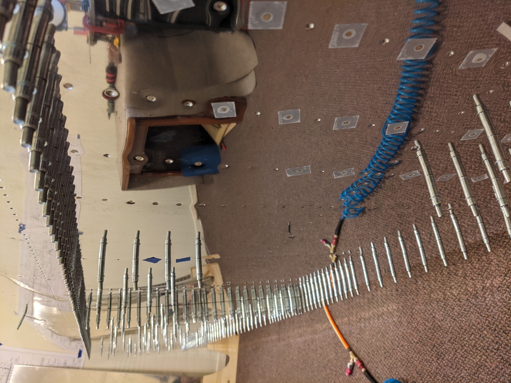

I used 3M Heavy Packing tape. Draw an "X" on the sticky side as a target for helpers. Make up a bunch for a long session. Cheap.

"X"

Not at all. It's for rookies helping me. My flush set has marks on it. They align the marks with the "X" on the tape. Rivet is dead center on the flush set. I found helpers learned the gun faster than the bar so I always buck.
