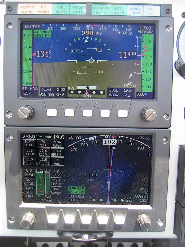

I shot this picture of my EIFS today after climbing to my initial cruising altitude of 11.5K over west Texas, headed to Houston.
A few things to note...
1) Range is showing 956 (nautical) miles! With 368 miles to go to Houston, I could have kept going along the Gulf Coast for quite a lot farther if I'd wanted!
2) Endurance was showing 5 hours, 20 minutes. Later on, after I'd climbed up to 13.5K, I was showing a combination of Endurance (to go) and Elapsed Time (since take-off) of greater than 6 hours!!
3) Elapsed time since engine start (not shown in this shot, but it's on another screen I looked at moments later) was 22 minutes - and that included a very long taxi to the active, as well as the climb to 11.5K'....
It's hard to argue with performance like this - these really are traveling machines!

I'm curious about your EFIS #2 voltage feed showing 11.9 volts - what gives?
Old 05-21-2007, 08:03 AM
Ironflight's Avatar
VAF Moderator / Line Boy
Location: Dayton, NV
Posts: 12,247
Sharp eye!
That's the Aux battery feed - it is a little battery that is trickle charged off the main battery through a resistor and diode, so it is always just idling along (it never sees alternator voltage because of the isolation). Prior to (and during) engine start, it takes the EFIS load, and then relaxes once the alternator is up. The EFIS will operate down to about 9.0 volts BTW.
