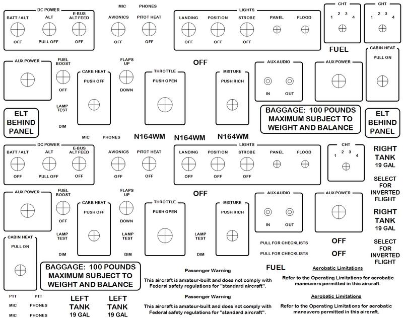

I have decided on dry transfers for my panel markings. My panel is painted with 2k acrylic urethane. Is there any consensus on what paint to top coat the dry transfers with? Type of paint? Matte or satin finish? I would prefer to go directly to the right type rather than buying 12 different rattle cans

I didn't use anything. 12 years and no issues.
I never touch the markings, so there is really no need to topcoat them. Also, if you need to change a switch function or similar, you can work the old markings of with a toothpick or similar.
If you have a marking that is going to get touched or rubbed, then a light coat of Krylon matte will work. Don't hose it down or the lettering will dissolve from the solvents.
BTW, I just used customrubontransfers.com and they are good and inexpensive.

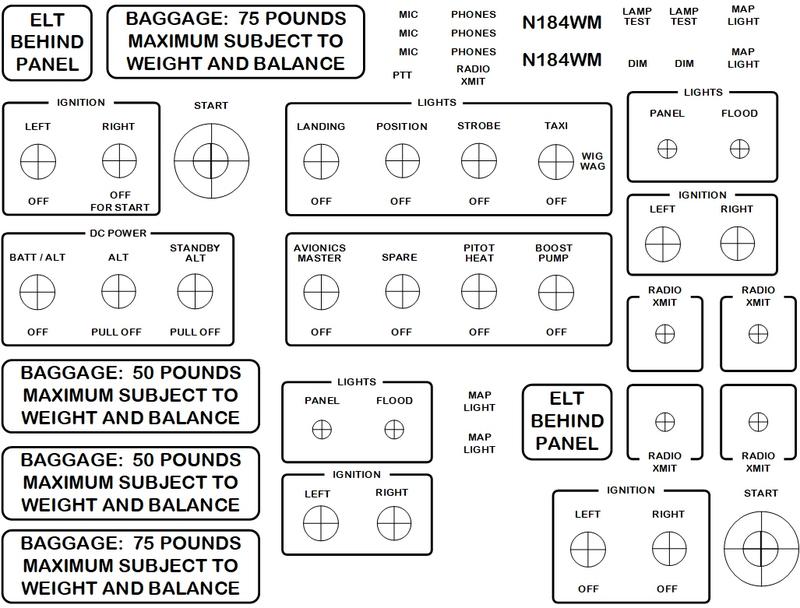

Easiest sequence is paint, apply transfers, install switches. But, you do have to be careful after applying.
If you use surrounds (lines) around the switches, it will be very hard to apply with the switches installed. Here a couple examples of my sheets (used Visio)
Make your target lines, etc. a minimum of 1point, otherwise they can't print them reliably.
Notice you make extras! Nest things in like a model decal sheet, but remember to not break up groups.
Tape the sheet section in place and apply the transfers with craft store burnishing tools (wood handle with various size metal ball ends, check the metal embossing section.)
