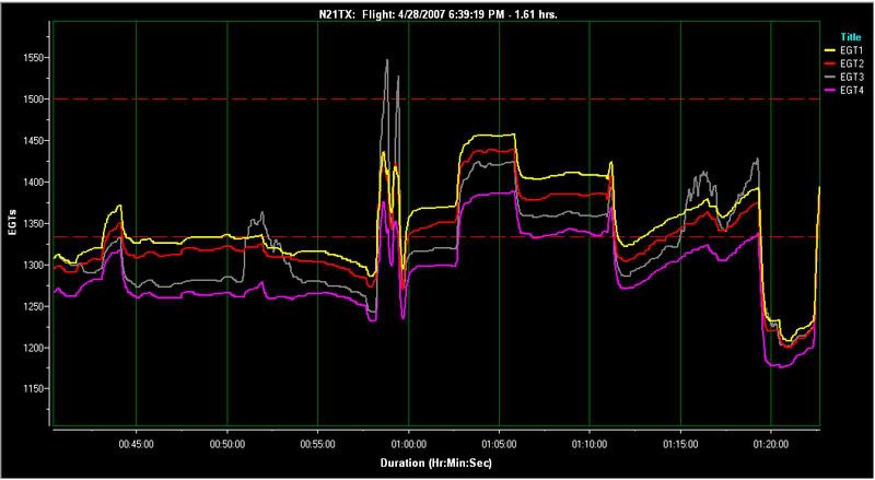

After checking the plane over and making sure there were no fluids leaking or no obvious problems, I sat there and thought about it. I reasoned it must be an ignition problem and most likely the electronic side with such a difference. I tested and found she would run at full power after passing through the stumble area. So, I headed home and downloaded the flight data files and analyzed it with EGview.

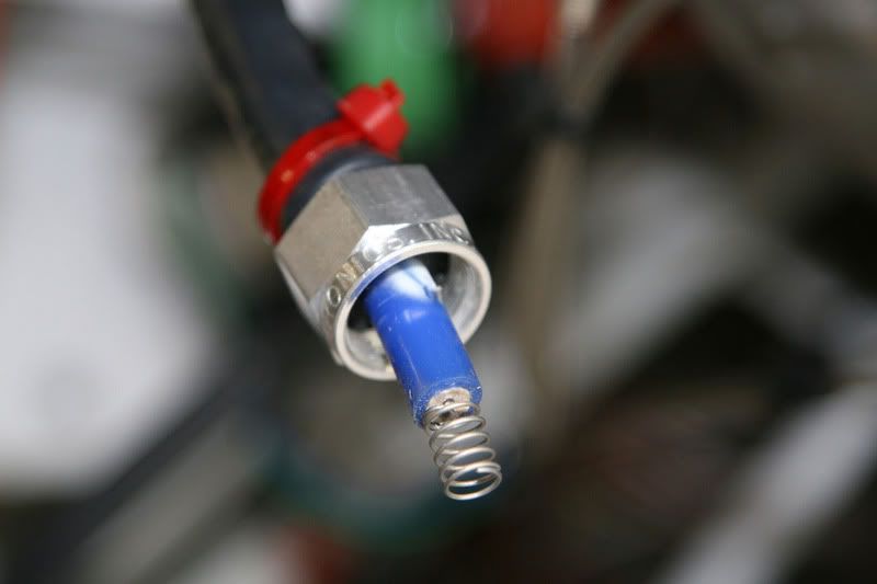

Normally the #3 EGT (gray) runs in step between #2 and #4, but it was obvious #3 was deviating higher during the times I was experiencing the stumbles. According to the data, #3 was the starting point. After removing the cowlings, I pulled the lower (Electronic) plug on #3.........Bingo!
I recently replaced the leads on the electronic system and apparently had the end of this spring connector looping back towards the lead skin. It took it about 6 hours of flight time to break through and short out the plug. Without the help of recorded flight data, It might have taken a while to figure this one out.
