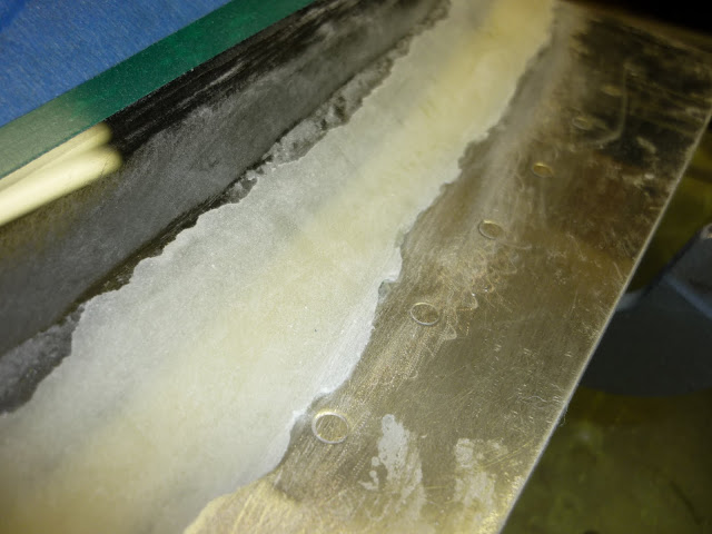

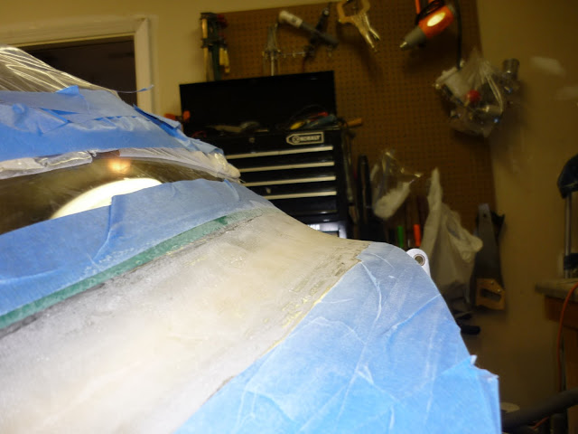

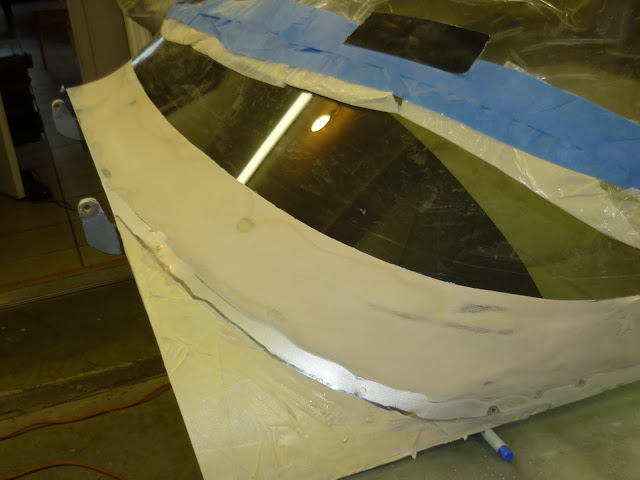

Default been a while since my last update.

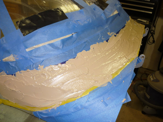

finished the canopy frame and just got done sanding the final canopy fairing..
FLOX
5 layers of S Glass
after sanding the glass it was time for the filler....2 rounds of filler and sanding..
Finally...

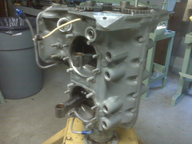

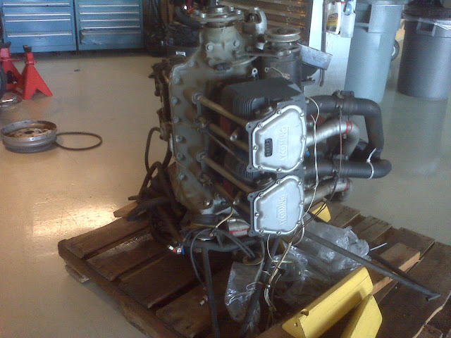

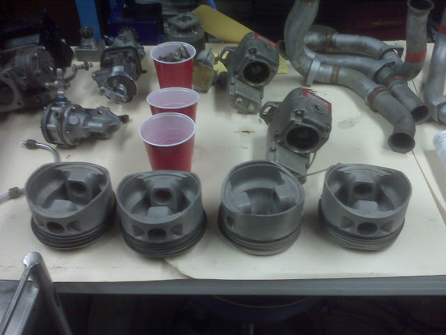

Managed to seal down an engine...
IO 360 AIA 200HP...
has less than 200 hrs when removed, no damage, not wrecked... been pickled and in storage for 2 years... it is being torn down just for inspection and to perform any ADs.. the inside is beautiful...no surprises.
prop gov included..
