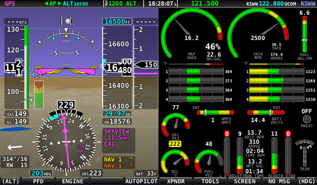

I have been doing some econ cruise testing at altitude recently, preparing for some real long-distance flights. At 16,500' the other day with a calculated ambient air pressure of 15.28 in Hg, my manifold pressure was showing 16.2 in Hg at 149KTAS. I am using the James cowl and a K&N cone-shaped filter into the forward-facing Superior sump. According to the theoretical maximum ram air rise, I'm achieving just about all there is to achieve - or else I calculated the ambient pressure incorrectly.
EDIT - chasing down the numbers I think I did foul the calculation - I believe it should be 16.48 ambient pressure. Perhaps someone smarter than me could verify?
