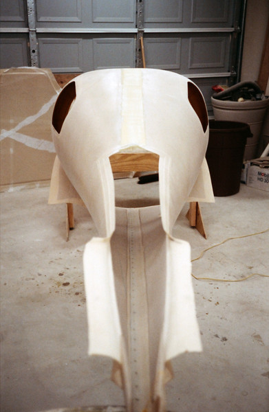

I think "joggle" is more of a fiberglass term. It's where the surface is recessed to allow another piece of fiberglass to be bonded into the recess. My Lancair kit used "double joggles"; The first joggle as above, and the second recessed even more to allow a bid tape to cover and reinforce the joint. These are double joggles where the empennage will go:
