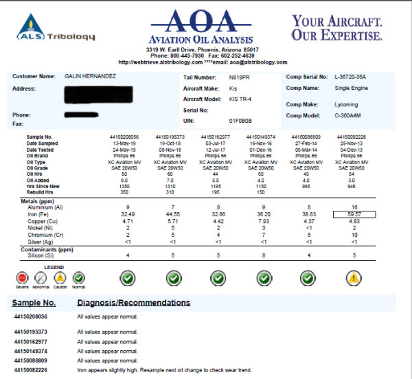

Remember this is about trends not absolute numbers. But there have been occasions where an issue was identified with oil analysis before a problem happened. When I was in the USAF as a RADAR technician we did periodic oil analysis on the massive electrical motor that rotated the RADAR antenna. One day we got a note they were sending us a replacement motor because the oil analysis showed a main bearing was failing. We replaced the motor and sent ours back to Depot. They later reported the analysis was correct and one of the main bearing was so bad it probably would not have lasted another month. Since then I have been sold on the program. Thankfully my airplane engine oil analysis has always come back normal. The way I see it the $12.30 I spend every 6months for oil analysis is an insignificant cost of airplane ownership. YMMV
Originally Posted by Bavafa View Post
I use Blackstone and they have been great in providing useful info as what the report means.
FWIW I use Aviation Oil Analysis (AOA) by ALS Tribology instead. No real reason to use one over the other, just stick with whichever you start with. Remember it is all about establishing a trend so anything different quickly sticks out.
They also provide a graphic display of all the items for easy trend analysis. I just didn't want to upload all the graphs from each item.
