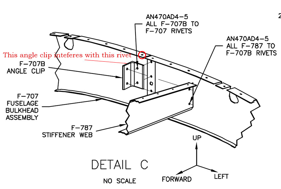

The aft top fuselage skin is ready to be riveted, but there is one skin rivet that's giving me problems.
This skin rivet is directly over the F- 707B angle clip shown on drawing 26, detail C and there is no way to buck this rivet..
In my frustration I compounded the problem by drilling out the skin rivet hole to ⅛" thinking I would install a Cherry rivet but the Cherry rivet hits the angle clip well before seating. I relived the angle clip some with jewelers files to see if that would give me room for the cherry rivet to seat but I stopped before relieving too much material.
The obvious solutions is to drill out the AN470AD4-5 rivets that hold the clip and rib to the F-707 bulkhead and reinstall after the skin rivet is bucked.
BUT, I'm afraid of screwing up the AN470AD4-5 when reinstalling. These were obviously originally installed without the top skin on from F-707 aft. The squeezer will not fit up there with skins on and one would have to use an offset rivet driver to buck the -4's and I have had mixed luck with those offsets....
Soooo....How important is this one little skin rivet? Not very I assume.
Any Ideas??

I doubt leaving it out will be a problem. However, you can grind a relief in the angle piece to allow the cherry rivet in, as long as you can maintain the edge diestance of the hole in it. A die grinder should make quick work of it.
For the future, an MK-319 is an acceptable substitute for -3 skin rivets and is very short. Probably would have fit.

I vaguely remember this joint.
I think you identified the secret and it is 'order of assembly'.
Your choice on how you attack it though. A pop will certainly work.
Just an FYI, on a few occations I had problems with the pop being too long. However, sometimes you can partially pull the pop rivet in rough location to make it short enough to fully seat the head before finishing the pull.

I?m almost to this point as soon as I get the parts primed. I think the instructions say to rivet the clip to the rib but not to the bulkhead until the skin has been riveted on. I don?t have them in front of me but that is my recollection.

I ground the bracket maintaining edge distance but it was borderline as I remember and ground the cherry pull stud down a bit as well. I was up to a 4 in this hole. I have since found good 3'ish pull rivets after I started the canopy.
It turned out good but there are a lot of rivets on the plane and in this area specifically. I am not concerned about this rivet. This may be covered as well if you are doing a slider, I think.

Yes the QB shop did me a favor and riveted the angle clip in....just one of many favors :mad:
I think you?re correct. Too bad the QB shop didn?t read that passage :rolleyes:
Clip
Correct. I had a reminder tape there. Felt good to finally get all that riveted together.
The rivets are not difficult. Secure the double offset like Bill recommends. Go slow.
