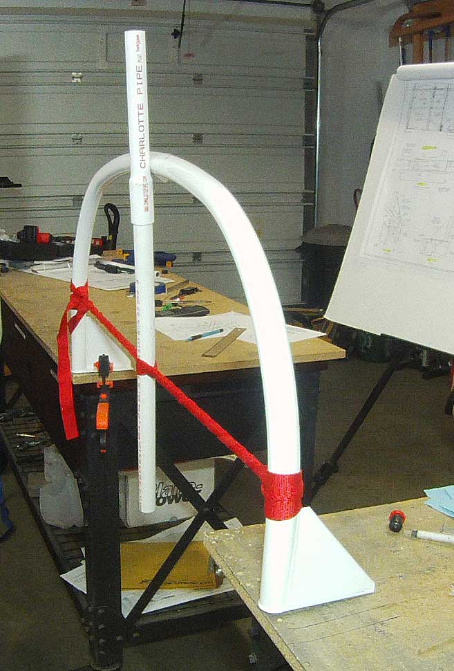

The -7 roll bar is one springy piece of metal
The roll bar is 7/32" too wide. So like a lot of other builders I got down to the job of adjusting the bar.
Currently, by squeezing the bar in by 3"... I've gained about ⅛".
My question is - how much can I squeeze the bar? Will it fail?
Roll Bar persuader.

That's a pretty creative method.
To answer the question, it will fail but no idea when.
I can't remember how much I squeezed mine but it was scary. It took lots of tries. Each was about an inch more. I used a come along at the base flange so it could be released gently. First attempt was a wratchet strap. It actually made it wider when it snapped loose.

I had about 3 ratchet straps cranked WAY down on mine, then stood it up on its side and gave a few good pushes on the other end with gravity's help to try and narrow it up.
Unstrap, re-measure, repeat. Thats a seriously substantial piece of 4130, I wouldn't be too concerned about it letting go before you get to your final dimension. The ratchet straps on the other hand....

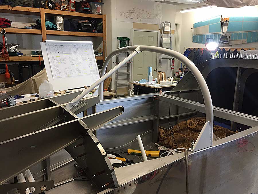

View C-C...Hiding in plane sight

I tried that after you mentioned it...no joy, I guess I'm weight challenged...couldn't get it to budge
I just kept winding up that strap until it was right. BUT, I noticed after test fitting the bar that I had gone backwards .
I then realized the fuselage sides were moving (when I leaned on them) more than I was trying to correct for.
Soooo, I installed most of the forward upper fuselage assembly and things quit moving around.

Success The roll bar is drilled (pilot holes) and in place. Man that's scary bending that bar
The forward brace is just propped up, not installed yet.

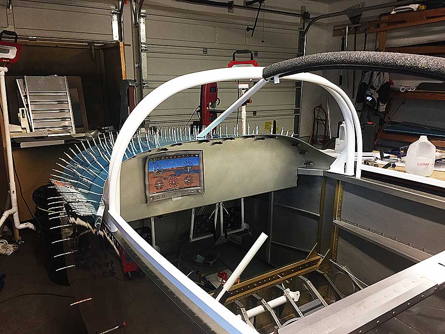

Installed the forward top skin and everything still fit properly.
Here's the roll bar cleo'ed on and the top skin in place...I couldn't resist putting the canopy frame in place just for grins.
