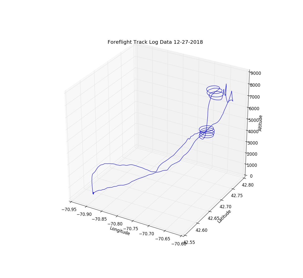

So last week I decided to fly some simple tests to determine how useful the Foreflight Track Logger is in capturing data for Flight Tests.
So I flew a simple plan which consisted of taking off, flying wind speed and direction circles at 5000 feet and then again at 8000 feet, then doing some simple aerobatics to see if the Track Logger could also be used to tell me how I'm doing with the acro.
The results were interesting. I downloaded the CSV file from Foreflight and wrote some Python to capture the data and plot it out in 3D.
The short answer is - the Foreflight Track Logger might be useful for Phase 1 flight test of climb, airspeed calibration,best glide, Vx Vy determination etc.
Doesn't seem to be useful in showing a round loop.
This is the 3D plot of the full flight. The roll, loop and roll is the track at the far right of the plot:

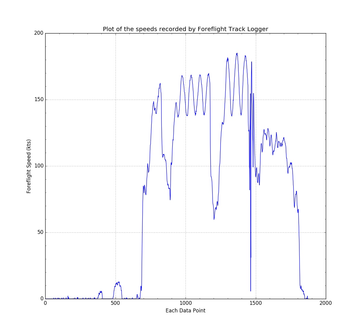

This is a plot of speed vs data point from Foreflight. It clearly shows the 4 circles I did at 5000 feet and the 3 I did at 8000 feet. It would be simple to extract the min and max speed from the data as well as the course at those speeds:
But one thing I noticed was that when I executed the loop, the data capture rate seemed to slow down - it didn't show a smoother loop, and also I noticed that the capture rate increased with my speed:
I over-plotted some data points with stars and in red showing the time period just after the entrance to the loop and well after the loop. Notice how the data points are sparse during the loop and increase in data rate during the exit from the loop and the pull up:
I wonder what causes the data capture rate change? Aerobatics causes a loss of signal to the Stratus 1?
General Foreflight Track Logger operation? I have to look at other parts of the data file where the speeds were slower (like take off and landing) to see what happens.
Is the data capture rate consistent in normal flight (i.e., when the Stratus maintains LoS to the satellites) or does it change with speed as well?
It's possible the GPS loses its connection to the satellites in a loop due to interference. It's possible the unit could be falling back to sensor data to interpolate at a lower rate.
I could see something like, with a 1Hz sample rate and the unit giving the gps 3 tries, you'd effectively have a 4Hz interp rate or a 1Hz GPS rate.
However, if the data changes sample rate with speed, then it could be distance sampling, which I would think be an unusual approach, or it could actually be changing the sample rate on speed.
You could plot sample rate vs speed vs altitude and look for a correlation.
  #20
Old 12-31-2018, 09:26 AM
Join Date: May 2006
Location: Pocahontas MS
Posts: 3,884
Try plotting the points during the loop over horizontal distance. Are they really farther apart, or just appear spread out due to the vertical component?
