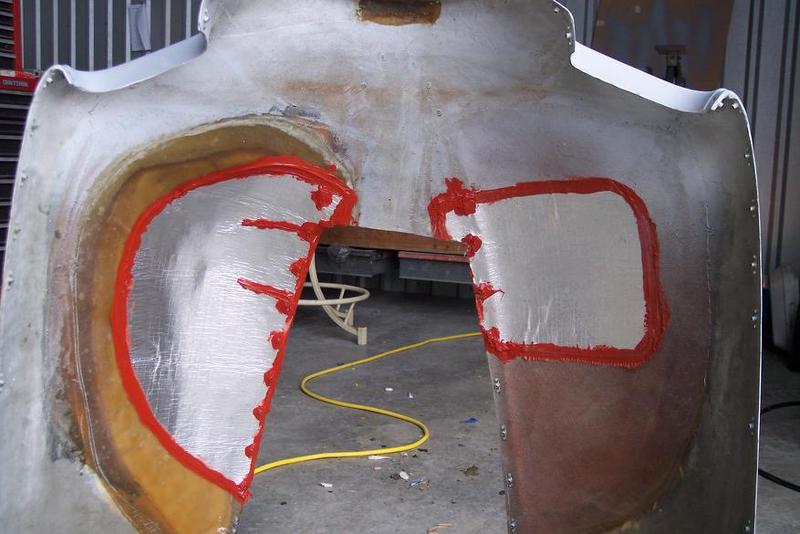

Anyone use high temp epoxy resin?
Aeropoxy or what do you recommend?

I used the West system and have not had any issues on my -10...
In what application, please?

Yes, but still have this question as they generally require a specific high temperature post cure and are very tender and weak until fully cured. PTM&W does make a wide range of excellent products, Aeropoxy among them. The Tech line guys are outstanding.

Yes, there are 'high temp resins', but according to an engineer I trust (he designs resin systems) they all catch on fire at about the same temp. I was looking for some FWF parts to be made from a 'High Temp' resin, but it turns out the high temp stuff will still burn when near a heat source like an exhaust manifold etc. He did mention the temp where they all will burn, but danged if I can remember what that was - maybe 450F or so?
If I am recalling the conversation well enough, the 'high temp resin' has a higher post cure temp, and that is about it.

MGS L285 is an excellent choice for post cure composite work.

Good numbers for a room temperature cure epoxy. I have some exit parts running very close to a hot tailpipe without issue.
https://www.aircraftspruce.com/catal...tr212resin.php
West 105 has very low temperature ratings.

Custom plenum and air intake. Maybe not really required but I ordered my last air intake in high temp epoxy from Sam James and it worked great. Previous one scorched from the exhaust proximity.
Think I'll just make plenum out of West Systems but was curious. I get the high curing temp as well which would be difficult in my application.

DPL862 is a widely used base stock for most epoxies. The manufacturers add their herbs and spices to change various attributes. DPL 862 turns to apple sauce when cold but its easy to fix by keeping it in a metal can and putting it on low heat before use. The additives typically used to prevent crystallization also weaken the epoxy.
Nice thing about DPL862 is its about half the cost when you take out the middle men.

Here's a data point. The EZ builders were making their engine baffles out of fiberglass 30+ years ago, and I doubt they were using exotic high temp epoxy back then.
I can barely *spell* 'layup', but if a fiberglass item was scorching from exposure to heat from the exhaust, wouldn't a radiant heat barrier would do more good than higher temp epoxy?
