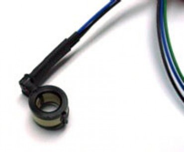

Originally Posted by rv8ch View Post
Jim, Not 100% sure this is on topic, but I use one of these from GRT:
My guess is that this is a pretty simple part, based on a bit of internet searching. I'd guess it would be cool to know how it works, and how to build one ourselves from basic components.
Thanks for your articles, I really enjoy them!
This is exactly the concept; the only question that remains is how big is the hole in the center of the doughnut to pass a wire that will handle X amount of current.
I've got my choice of nearly a hundred cores and I want to make it as small as possible yet still make it capable of handling MOST of the folks that want to make one.
So the fundamental question still presents itself. How big does the hole in the doughnut need to be?
BTW, I'm shooting for a sensor using a hall-effect device and hope to keep it under $10 to build.
Jim

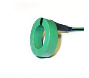

Old 01-05-2019, 06:08 PM
GalinHdz's Avatar
GalinHdz GalinHdz is offline
Join Date: Mar 2010
Location: KSGJ / TJBQ
Posts: 2,034
This one (CS-01) has an internal diameter of .86" and can be used up to 100amps.
This one (CS-02) has a smaller internal diameter and can be used up to 50A.
FWIW: I use the CS-02 (50A) in my airplane with a #6AWG cable running inside of it to monitor instrument panel current draw on a DYNON SkyView system.
