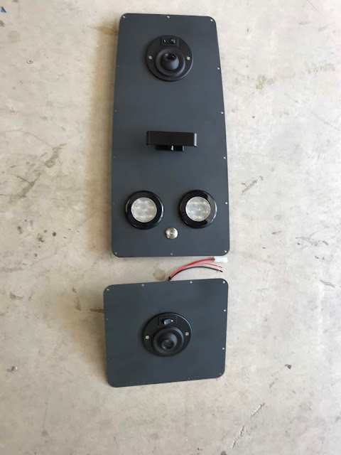

Funny the little things I got hung up on during this build. Overhead lights were one of those things. With a full glass panel and lighted switches I didn't feel the need for glare shield lights. The only non-lighted switches are the batteries and alternators. Pretty easy to feel out and with the glass will actually be able to see them.
I still wanted white cabin lights for night time loading and unloading. But I also wanted some type in-flight night lighting if need be. There are some studies out there about which color is the best for retaining night vision. The jist I got from it is that it really doesn't matter if it's a greenish-blue, low intensity white or the tradition red we all know. I did however decide to go with red.
Here is my set up-
Have it actually installed now and I like it. I got these all from https://www.pilotlights.net/

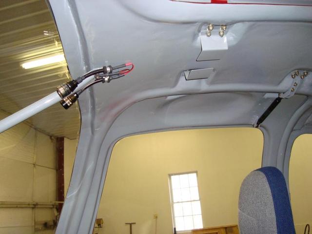

Check out “pilotlights.net” They have a good selection of led light products. I do not have an overhead console, so I used an led down light, dome light. I trimed it so the light blends in with the cabin top center support. It has both white and red led lights incorporated. I also used the mini gooseneck lamps with red leds. Mounted one each on the far right and left side of the panel.
