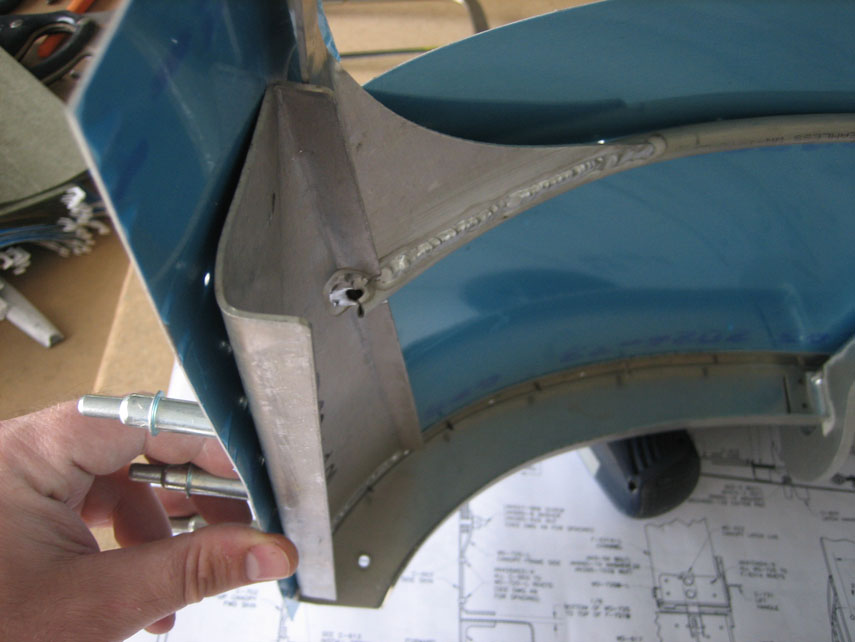

When I cleco the C-702 skin on the WD-716 canopy frame there is a huge gap between the skin and the aft tube of the WD-716 near the ends on both sides where the skin wont touch the tube. I cannot seem to find any resources on this and do not see how to get it to lay on it without lifting up in the center... Please help.

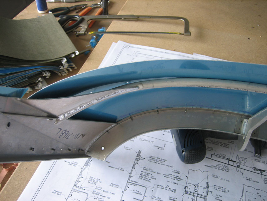

I wanted to follow up on my post with some pictures. I saw a message in the archive from 2003 that Steve Sampson posted about his RV-9 having the same problem and Ken Scott told him it was welded incorrectly. So I wanted to post some pictures to find out if everyone elses has the same issue as mine or if mine is also welded incorrectly. You can see that the skin has prepunched holes above the tube but there is a 3/8" gap between the rivet hole in the skin and the tube...
<P>
<P>

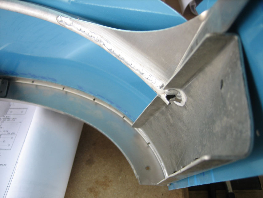

Here is what the tube looks like welded to the side, doesnt look right...

All of the ones I have seen (including mine) are that way. I didn't use at least the last two, maybe three, rivet holes there. Some people shim the space or fill it with epoxy or jb weld...

I had the same problem...I followed the Dan C fix and used some shims. It worked out great.

I have the same problem. Will probably just put some shims in there.

I too had the same problem. Had to shim and then filled with epoxy and balloons. Worked out fine.
I checked Van's RV-7A and found that the welded tube on the prototype isn't welded in the same location as on the production and didn't require a shim.
Also Vans RV-7A canopy top skin is dimpled for the countersunk blind rivets and the tube isn't machine countersunk. So the dimples ride on the tube and the skin is actually not in contact with the tube.
I machine countersunk the skin and filled and sanded the rivets.
Be prepared to shim in several spots on the canopy frame. I had a least 4 tapered shims to get things to fit well.

Maybe I am confused, but how do you shim 3/8" and have a rivet go that far down into the tube?

I shimmed the frame of my RV6 - but only by 1/8" on the last hole on each side. The RV6 instructions say not to carry the rivets all the way down the skin and just let it find it's own shape. Presumably because there is a funky and variable gap between the skin and the weldment in this area. Not sure what the RV7 instructions say. I'll post some pictures when I have time.

Here is a picture of the shim.
