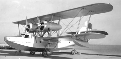

#4 here.... http://aviationweek.com/technology-m...images-1428111
The Hall flying boat may not be as pretty as the H-1 Racer but it flew 6 years earlier with flush rivets...
