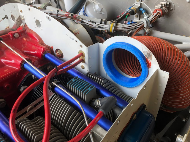

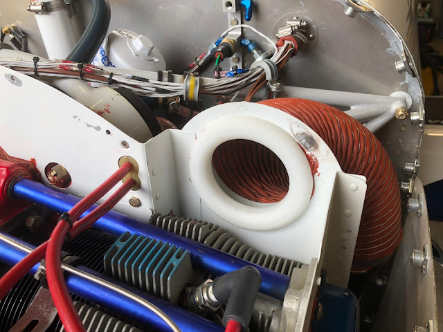

Hi Larry, I'm sure Dan will be along shortly with enough science to satisfy your need but I will give you my recent experience with the oil cooler inlet. I have a 15 row cooler mounted on the firewall fed by a 4" opening in the baffles. I have found that I can "neck" the flow down to 3" without any performance degradation in flight.
Here is the new cooler fed by a 4" opening that has been reduced to 3.5" with a 3D printed insert.
Here is the same 4" opening that has been reduced down to 3" with another 3D printed insert.
So far I have seen no difference in temps for any in-flight phase. However, I did see my temps at idle go up. What I can't tell you with certainty is whether or not a 3.5 or 4" opening would have done any better at idle.

No matter the size, you can bet that those adapters Darin printed helped flow into the SCAT tubing a bit. They look a lot like a properly designed intake runner, inside a plenum. Almost makes one wonder whether the reduced turbulence into the SCAT made up for the smaller passage.

It is a common myth that the smallest restriction somehow sets the flow rate for the whole system. The transition shapes are probably much more important than some minimum section area, particularly in short ducts like these oil cooler ones. The restrictions shown in one of the posts might make the system equivalent to a much smaller, but well transitioned, hose. The transition back to the full rectangular face of the cooler is perhaps more important than the inlet transition.
