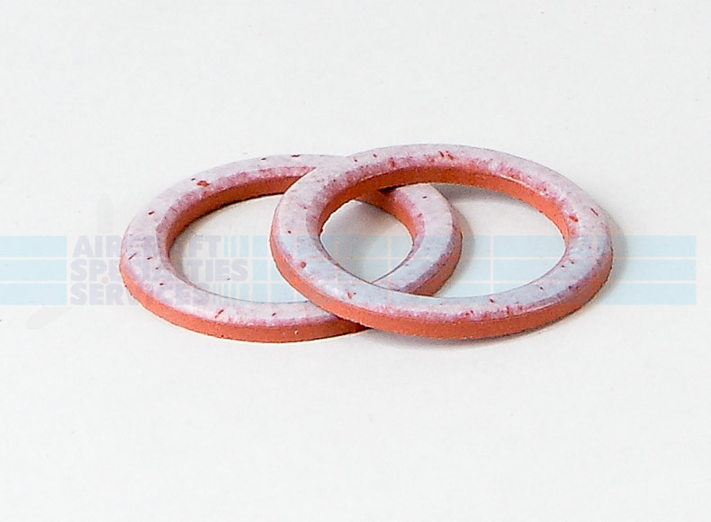

It's not a crush washer with an inner crush material, it's looks a solid copper washer that is quite wide -
Perhaps the washer (70455) is embedded in there and the black goop was between the pulg and the washer?

The gasket that is recommended by lycoming is not a crush washer, it is a ring of gasket material.

We ended up getting a 3/4"-16 helicoil kit and new gasket for the cap.
It looked at first as though the leak wasn't any worse than it had been. Flew the plane and it was much worse. 2.5-3qts on the fresh paint.
Now that we have good threads there, any suggestions on sealing this up?

How was the case surface under the gasket?

I looked at those parts after remember incorrectly. The seal has to seal on both the outer shaft and the case, though only the seal with the outer case is relevant. However, the shaft does limit the travel of the cap, so the two surface need to be on a relatively level plane. In your picture, the case flat area seems pretty rough. Is that just the picture or is there some pitting or gouging there? If there is, you'll probably need some sealant in additon to the gasket.

In the above pictures, there is no gasket. There was some remaining B1/2 that was cleaned off with a scotch brite wheel.
