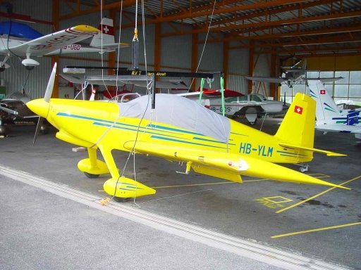

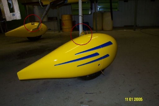

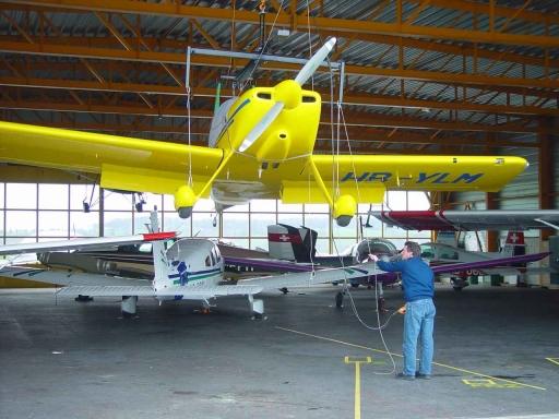

Hello all.
Here in switzerland it is very common to hang up an airplane in the hangar. Hangarspace is very expensive and nearly not available (you have to be on waitinglists up to 20 years!!!). So every space is used.
The stainlessteel-thounge is attached with the same screw that hold the brake to the gearleg.
The back of the fuselage is supportet by an wide belt.
All this is connected to an steelbar which hangs on a electric winch. The winch itself is on a slider, so it is possible to take it to the front area of the hangar to let them down. Yo do not need to took all other planes out to go flying!
Works very good, especially when you have to do things on the bottomside of the plane Checking gears, breaks ...
The pictures are from my friend Yvar, the first flying RV7 in Switzerland!
Hope it helps,
Regards Dominik
PS: I hope to find an also clean solution for my RV-7A ... I'm still thinking about!

Thank you Dominik for the pics of how they do it overseas.
The frame and attachments to the axels do seem like the most elegant solution, especially for taildraggers. With the nosewheelers attachments points arent quite as obvious...
Was even thinking of using the steps and an attachment to the engine mount somehow but in the end I will probably build a lightweight platform.
Thanks again, glad to see you guys have it figured out.
