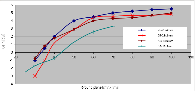

05-10-2018, 11:06 AM
Join Date: Aug 2016
Location: Asheville, NC
Posts: 2,092
Originally Posted by sf3543
GPS antennas do not need a ground plane.
Tell it to Garmin. The installation instructions for the GDL-82 require a large one under the GA 32 WAAS antenna. It's a matter of signal-to-noise ratio, I think. The bigger the ground plane, the more signal. You handheld devices can get away with lesser signal. From this graph, it looks like you get 5dB of gain with a 70x70 cm ground plane, and 0 dB with a 30x30 cm ground plane. If my math is right, you get 3 times the signal with a large ground plane.
(2020 dues paid)
