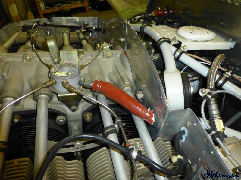

Larry,
I had the typical FI issues with my IO-360 - engine coughing on the ground while taxing, in the pattern occasional roughness when coming in for a landing, etc.. I added a second layer of fire-sleeve over my fuel lines, and voila! All my issues went away. The engine runs great on the ground and in the air now.
This doesn't cure the hot-start issue - that comes with technique, which isn't a big deal once you understand what's going on with the Lycoming engine pump
Before:
After:

Yes, the injector lines are a big part of the behavior, but understanding that is a big step toward managing it too. Airflow and fuel flow make the behavior go away, while high heat and low flow will bring it back. For example, you can "cure" the behavior with a runup (lots of fuel movement), but it will come back with a long wait at the end of runway.
