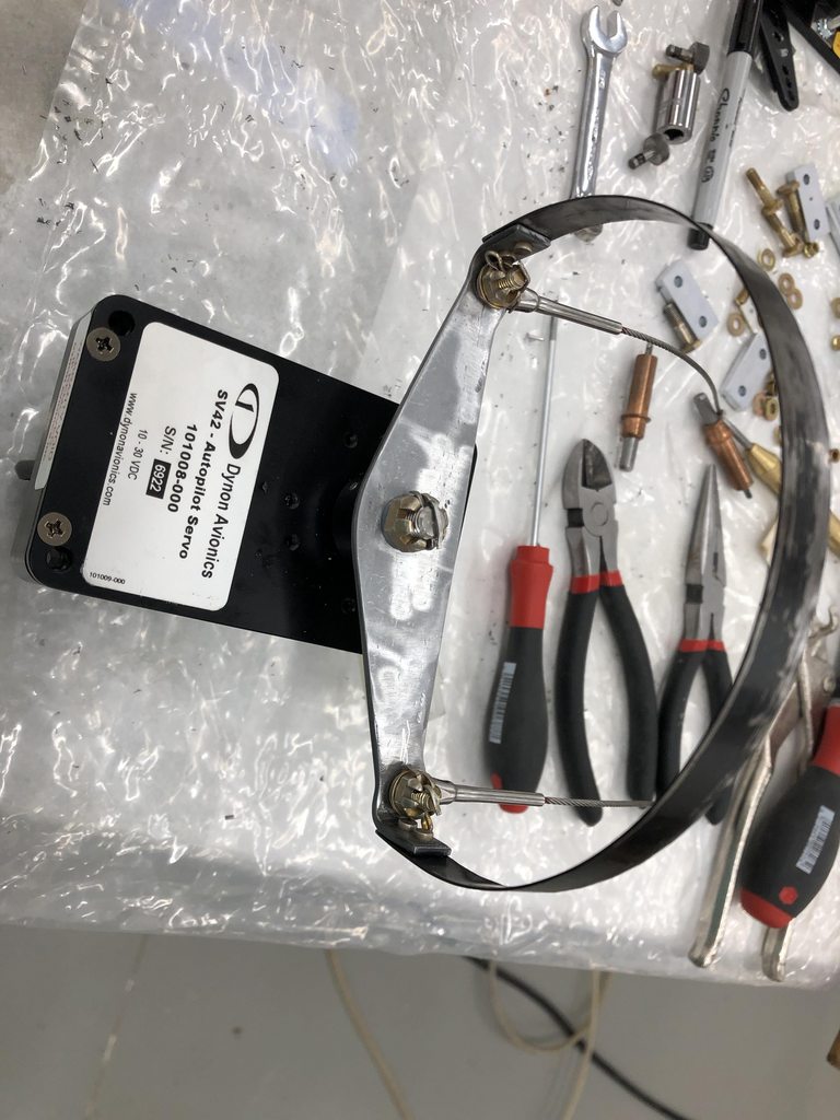

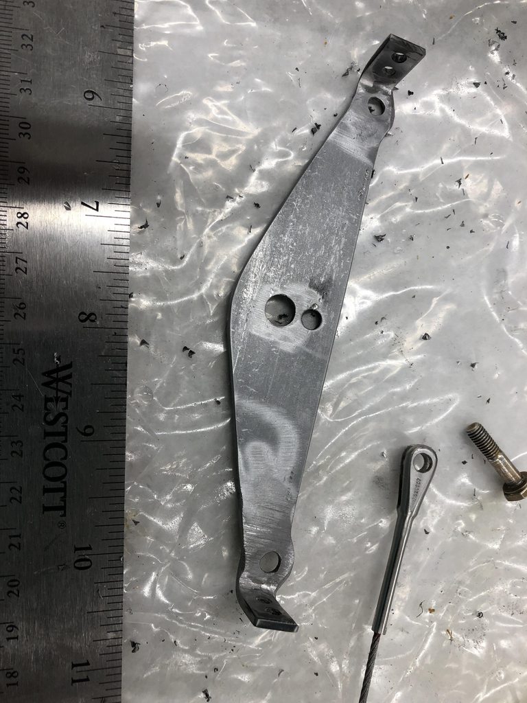

While we're on the topic of pricey mounting hardware
anyone reverse-engineered or home-brewed a tiller arm/bow for the Dynon yaw servo? Seems very pricey for what it is, and easy to fab from a bit of aluminum plate and an old hacksaw blade
All we'd need are a few major dimensions for hole spacing; the rest is eyeball-engineering with an eye towards keeping the cables from possibly fouling with anything.
