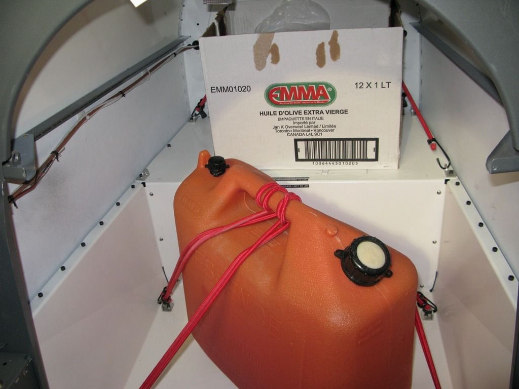

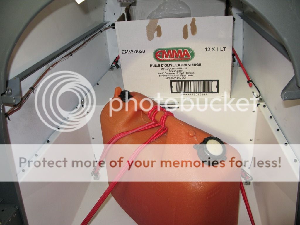

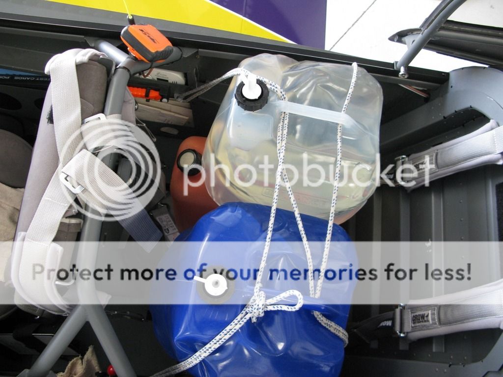

Water containers... Whatever you own or can borrow...
The idea of putting something abrasive or corrosive in my new airplane did not appeal to me...
This was an RV-8 @ max gross & rearward C/G...
