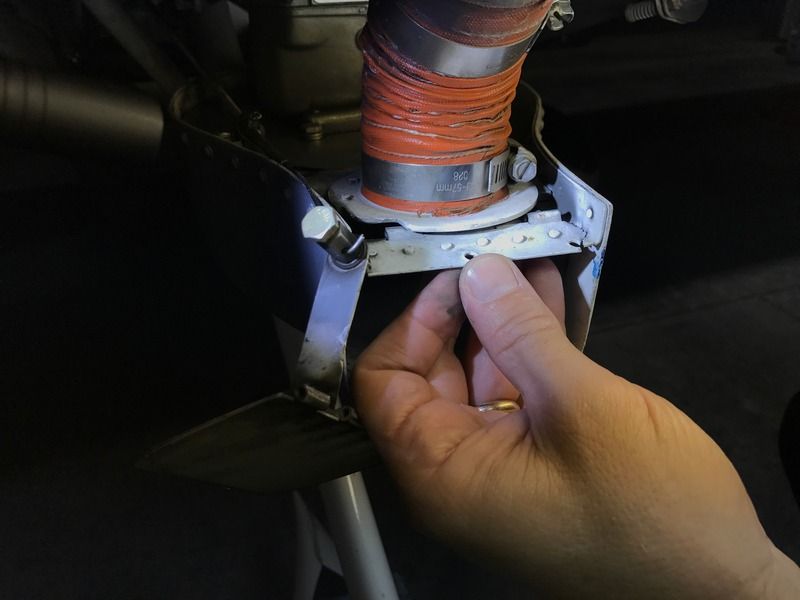

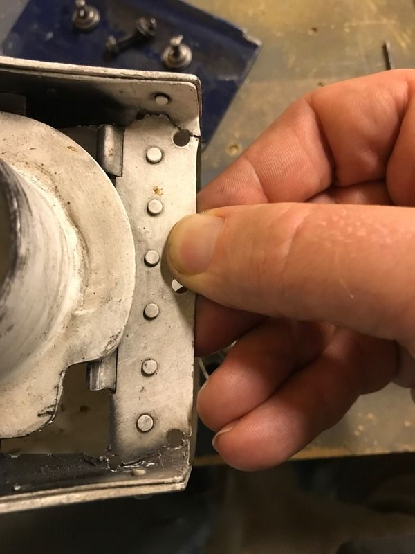

The portion of the airbox structure supporting the hinge for my carb heat door gave way recently. Here are some photos:
The part has about 290 hours on it. From what I can tell in the archives, this area can be a bit of a problem.
Pondering how best to repair this. Has anyone come up with any ways to make the assembly more robust?
I'm guessing that engine vibration/shake, especially on startup, is probably the culprit here. But nobody would mistake me for an engineer.

You may be chasing the problem from the wrong direction. The structure may be (or may have been) fine, but another problem caused it to fail.
How big is the gap between the aft end of the air inlet in your cowl and the front of the airbox? Too small of gap means there is insufficient room for the flexible seal between the airbox and cowl to damp out the relative motion between the fixed cowl and the wiggly engine/airbox. That stresses the airbox and could result in the failure you experienced.

When I fabricated my air box (completely different design) I used stainless steal for the hinge and composite for everything else for this very reason. Aluminum is prone to fatigue, and the last thing in the world I want is a part breaking off and entering the air intake. This is not an area that is easily inspected regularly, so I believe it needs to be as bullet-proof as practical.
From the photos it looks like you do not have very tight fitting tolerances on your air box. Any gaps or "baffle seals" will allow unfiltered air to enter when under suction on the ground. I would rebuild the carb heat section with a new design.

Kyle, you got this exactly right. Upon closer inspection, my airbox and cowl have apparently been swapping paint (literally) for a while, which no doubt led to this failure. I'll be sanding the air scoop back a bit before I repair & replace the airbox. I'll also be adding the cowl seal material to the "snout" of my airbox, as called for in the current plans (it was never installed on mine, possibly the plans were different back then).
Thanks again, your comment was a huge help.
