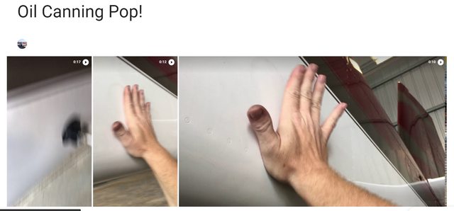

Is this the smoking gun? Here are three different cell phone videos that I took. Using various techniques of pushing on the skin. This is much louder in person.
I tried it with my Lightspeed's on and it sounds very similar to what I have been experiencing.
Click image below to go to video's:
Update: Turns out this was not the problem....real root cause further down!

Did you fly with the baggage wall out or just removed and reinstalled? it is structural and required. I have seen on here a pic taken where a close inflight shot during aerobatics shows obvious oil canning in the tail cone.
