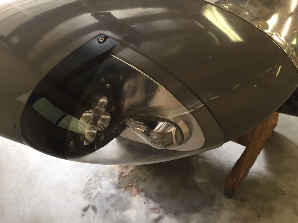

John,
Do you have any pics of how you did your Baja landing/taxi light installation? It looks like they are adjustable up/down and left/right using spring loaded screws, but it would be great to see how you did it.
Antony

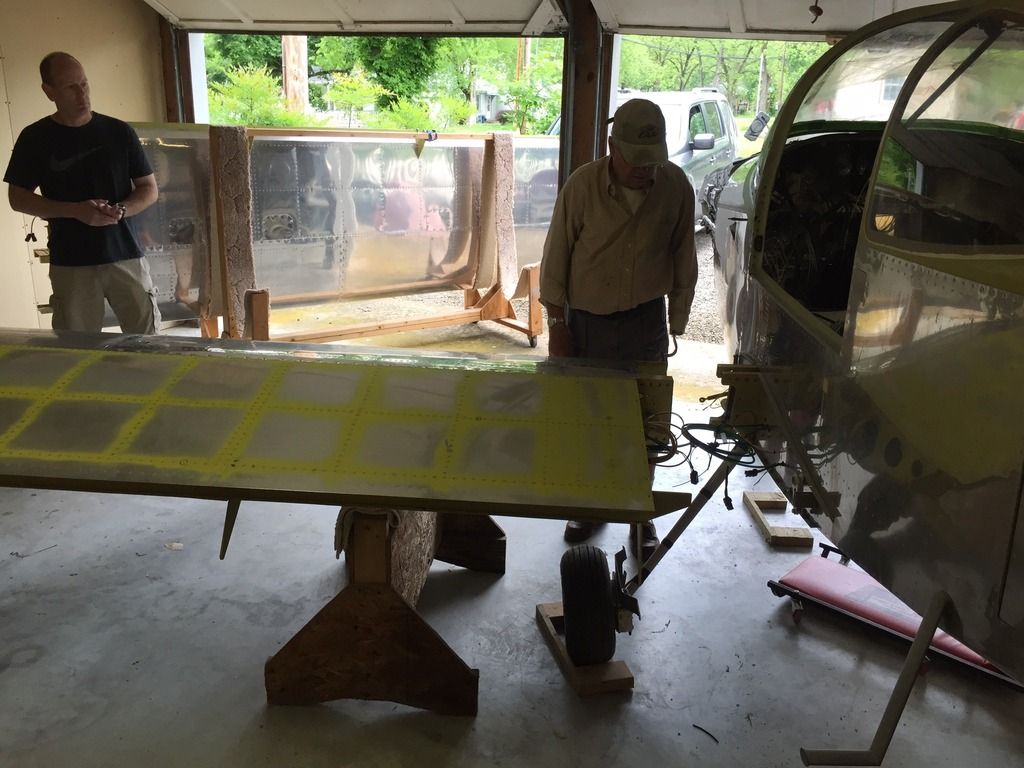

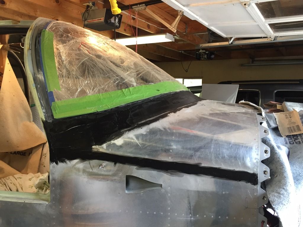

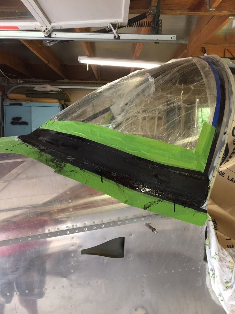

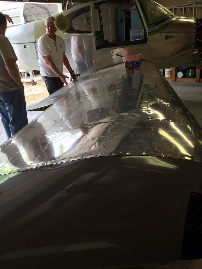

Originally Posted by Bluelabel
This update doesn't contain anything new that hasn't been done almost 800 times or so... but, might as well post.
We finally put in the Windscreen, and built the fairing. Went pretty well. Good thing I researched it here. Would never have thought to dye the filer and epoxy black until it was too late....
We also fitted the wings. So, that was kind of big deal. Actually went surprisingly easy. The plane got to get out of the garage and make Uturn back in.
Amazing that these wings left the factory in 2005 and the fuse in 2007, and they went together like butter. A lot to be said for Vans engineering and production.
Made and riveted in an extra bracket for the the windscreen. It disappeared under the fairing once it was all done.
Big thanks to the crew we had come out and help with the wings...
We figured out, between this crew we are responsible for 11 planes either built and flying or in progress... With Al and Shayne being the most repeat offenders...
Thanks to Al Smith (RV-6, Zeinith 650, RV-12, and currently a Zenith 750), Earl Starkman (25,000hr commercial pilot), Frank Klimek (Cub Replica and currently Sonex), Rick "Wingman" Wantz, Sonex), and of course, my father-in-law, Shayne (Sonex Waiex, Zenith 650, Zenith 601 and now the RV-10)
Only some minor trimming has to be done on the flaps..

Originally Posted by aparchment
John,
Antony
I didn't document this super well. If you email me I'll send you what I have. But yes, I made a plate that attaches under the Baja Designs front face that essentially filled in the gap in the shape of the lens. Then I used 3 screws to attached it. It's three screes, going into three nut plates, with spacers and springs to get the right tension so that it's tight and still adjustable. Just by eyeballing it during the build I was within a few turns of getting the lights just right. I was actually shocked at the the first time I turned them on with the wings permanently attached and they were almost dead on....
In the end I painted the lenses (actually vinyl) so you can't see the guts behind the light.
I will say that I'm super happy with the results. Obviously I stole the idea from other guys. I'd been using these lights on my offload trucks and motorcycles, but hadn't thought about this use.... They are truly badass lights... and ZERO interference with the coms..... My wife say that when I'm out flying at sunset, she can tell it's me from the hangar (a LOOOOOONG WAYS away) because my landing lights are so bright....
