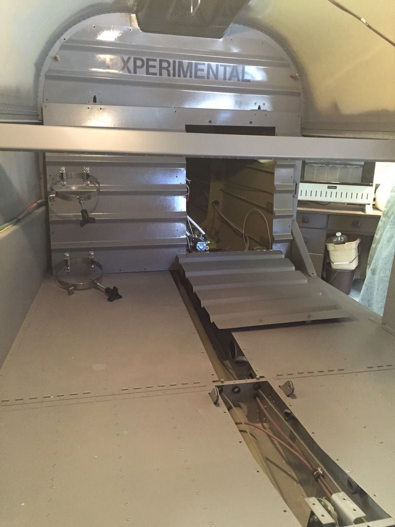

John, I seem to recall that the factory has previously mentioned that the baggage bulkhead is a structural item.
Although I think your splitting it, and hinging the one half is a great way to access the tailcone stuff------------did you run this past the Vans folks???
From the photo, it does not appear that there are any screw holes for the drop down half to be attached to the center post.
Looking good --------- I really like the interior side panels.
Keep shortening that punch list
Hey Mike,
The screw holes are there... just can't see them.. We didn't run it by Van's however, what you can't see is that we built a very strong structural frame around the entire opening for that door. I'd say it's stronger than before. We ended up with 2 baggage bulkheads so we were able to make the door oversized to overlap the hole, and it's held closed by 1/4 turn fasteners. I think it's rock solid.

here's a better look at the access panel
