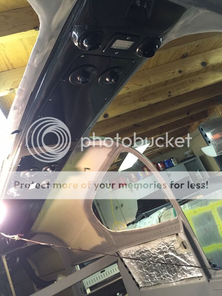

Originally Posted by Phil View Post

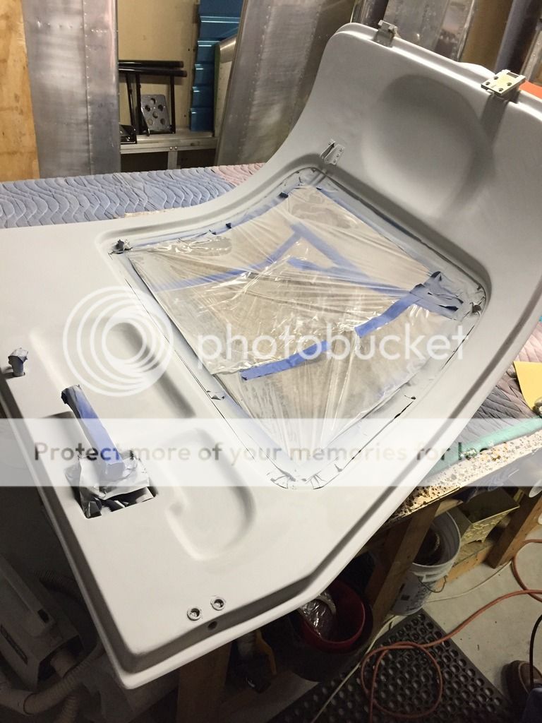

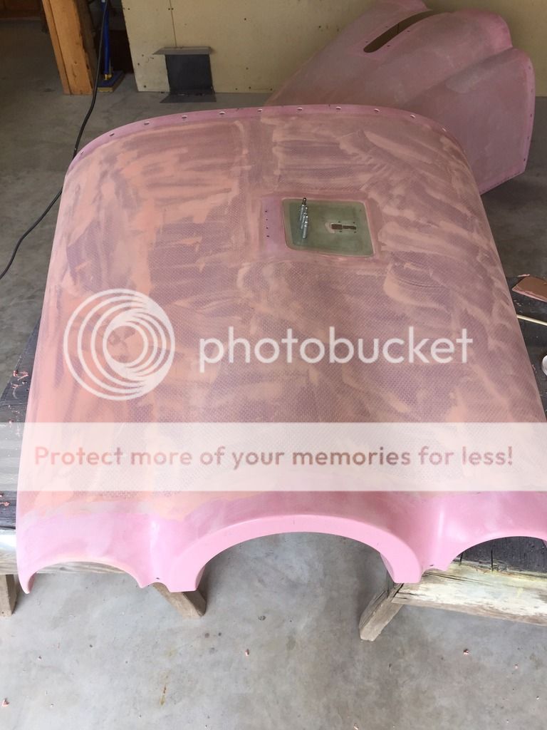

What are you going to put in the two cut outs?
Geoff (Aerosport Products) supplies aluminum access plates for these areas that are sealed. This was a problem with some of the fiberglass overheads that have been previously sold. A common complaint is air leaking around these access plates. These plates allow you to access to wiring, nuts, etc. I know some folks are planning DVD players that would mount to the rear access plate. The plates weren't in the photo, since Geoff literally brought it over as soon as it was done. I'm not sure which one of us was more anxious to see how it looked. He has another vendor laser cut his aluminum panels, which weren't ready yesterday.
Are you going to leave it finished as is, or are you going to get it covered with a cloth or leather?
While carbon fiber is quite a bit better than fiberglass in regards to pin holes, I'm going to fill with Leohle Wonder-Fil and paint. I'll run headliner material right up to the overhead console. I'm sure you can cover it if so desired, but that's beyond my skills. You might be able to get somebody like Classic Aero or Flightline to cover it for you.

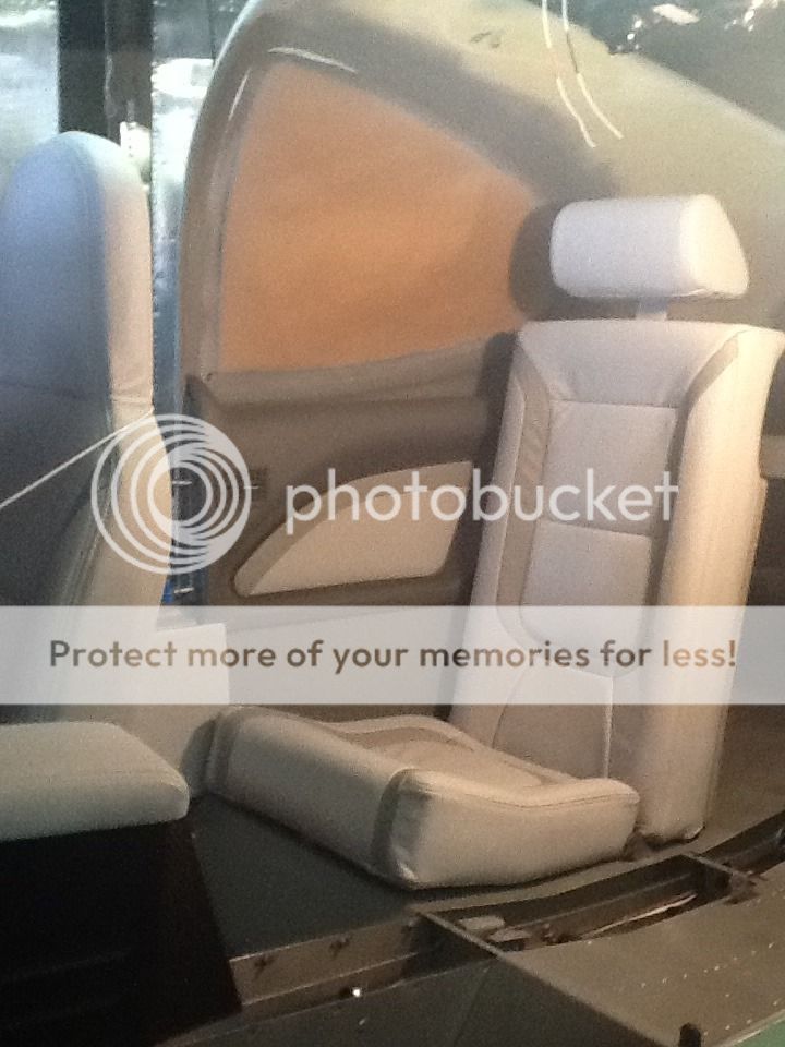

More interior work today...flightline interiors did a great job fitting...take a good look at the captain in the back seat ( 5th image posted ) I doubt you'll ever see it again. I had to grab that!
http://viewmorepics.myspace.com/inde...mageID=5629665
http://viewmorepics.myspace.com/inde...mageID=5629701
http://viewmorepics.myspace.com/inde...mageID=5629721
http://viewmorepics.myspace.com/inde...mageID=5629693
http://viewmorepics.myspace.com/inde...mageID=5629683
http://viewmorepics.myspace.com/inde...mageID=5629738
