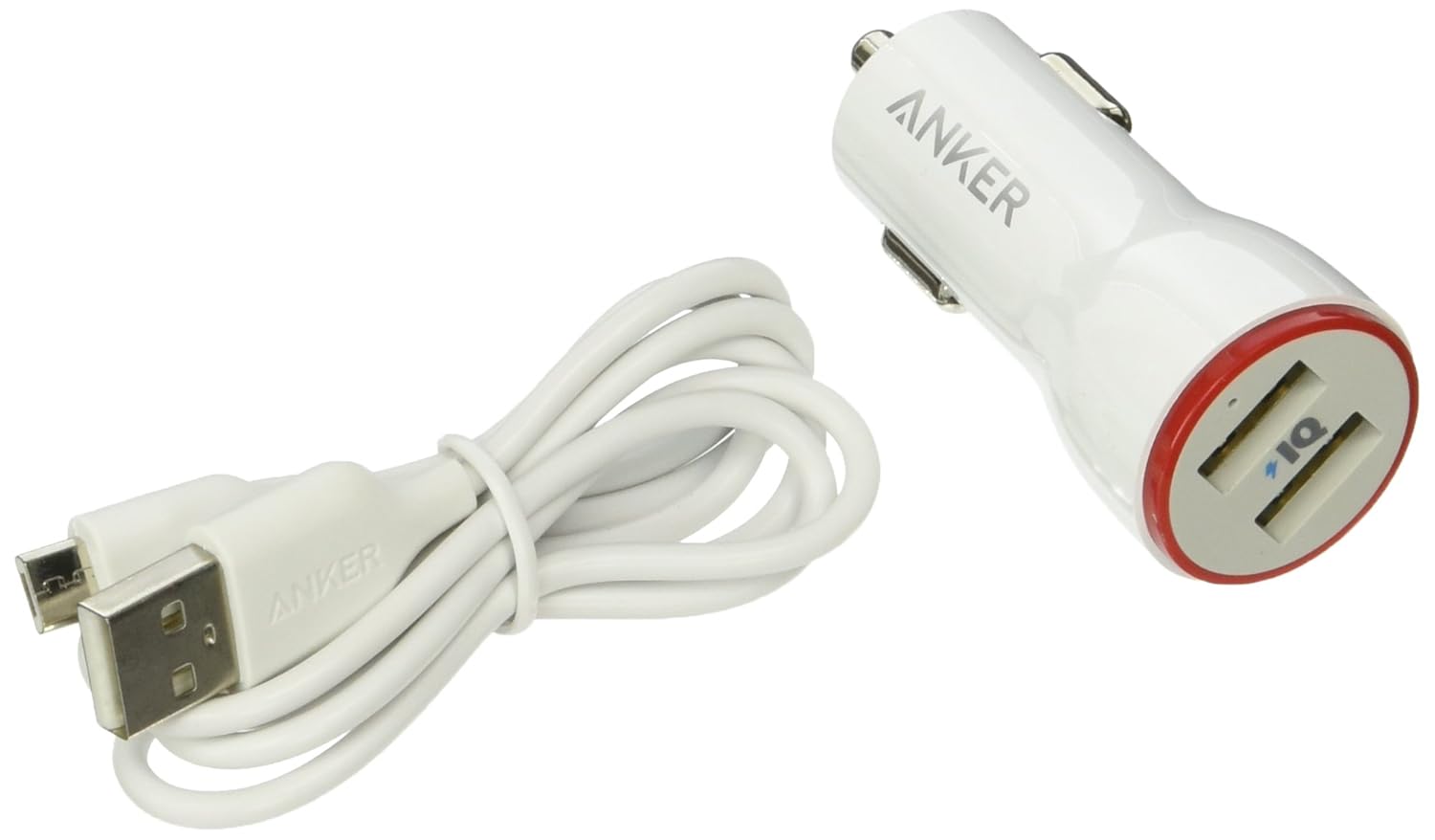

Has anybody tried one of these Flight Gear Dual USB Charger sold at Sporty's? Specifically, does it generates enough RF noise to affect comms?

I use this version both for both pilot and pax with no discernible system noise

Someone asked your same question online on the Sporty's webpage that you provided the link to. For what it is worth, the reply from staff was that it should not affect radios. I think I am going to try one.
+1
I have tried quite a few alternatives and the only one that would deliver more than 5 watts to the Ipad Air 2 and NOT introduce noise was the Anker Power IQ unit. Even Steins modified unit didn't work for me (noise free, but wouldn't send enough power to charge the Air 2- I understand it works well for earlier Ipads).

The links below provide some insight into the common problem with USB chargers not charging some devices at an acceptable rate. I don't know whether the Sporty's device discussed in this thread suffers from this problem or not.

Received the Flight Gear charger adapter and tried it out in my car, but not yet in the plane. On the plus side, it appeared capable of rapid charging my iPad Air, as it indicated 2.5 amps current when plugged in. The blue LED lights indicating voltage or current on the unit are pretty anemic however. Will try in plane next and see if any radio interference.
