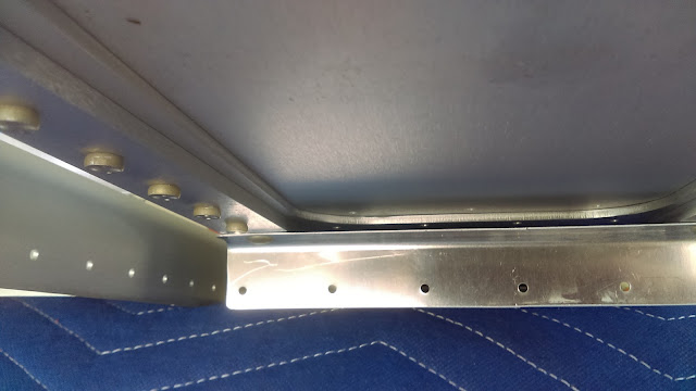

I'm confused by Section 13, step 5 of the RV-12 instructions. First, of all, as shipped from the factory, why aren't both spars mirrors of each other? The pre-riveted rib doublers aren't the same for both.
And as the schematic shows on this step, you're working on the forward side of one and the aft side of another.
This step tells you to rivet remaining open holes in the indicated doublers, basically three rivets on each flange.
But, at least on the underside of the farthest left doubler with open holes, doing so interferes with any rivet that would go in the opposite side doubler.
Maybe this isn't a problem in most of the doublers, but it is for the one farthest outboard (of the ones we're talking about in this step). The pulled rivet for the doubler in this step, will eventually interfere with trying to put a rivet in the flange holes for the doubler that's on the other side.
Or, if one rivet is to tie the two doublers together (and I'm positive that that's not the case), you would have to have a spacer on the back side AND a much longer rivet.
As you move inboard, there sees to be a bigger gap between the spar web and the doubler flange
Very weird

The spars are not "mirror-images" of each other because one spar sits further forward on the wing chord than the other -- remember that the spars overlap through the center-section. So there are different pieces required to properly establish the proper relationships of all ribs, etc.

The holes in the angle are over sized to allow the rivet to be inserted from the opposite side of the spar and not interfere with the angle. The rivets attach the rib to the spar web only.
Not trying to be snarky, but may I suggest that every time the notion comes to mind that something doesn't make sense or isn't working out like you would expect, that you just read ahead and see what is going to happen in that area later.
I would estimate that at least 700 pairs of wings have been built from the same parts you are working with, so if something doesn't seem right, the highest probability is that you just don't yet see the full picture.
David explained why the spars are different.... when the wings are mounted to the airplane, the spars are not aligned. One spar will be further fwd than the other, so the wings can not be built as mirror images of each other.

OK, so I even though I'd already had my Saturday Happy Hour beer, I drove back out to the hangar, checked the plans and figured out what you were saying. At least what I think you were saying.
What I think you were saying is:
"Those holes you think are rivet holes in the doublers angle on the other side of the spar from the angle you're riveting, may look like rivet holes but they are not. They're only there so the rivets you're inserting can be fully inserted."
