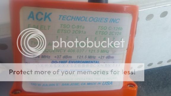

OK, maybe a dumb question, but I can't find the ELT battery expiration date. I thought it was supposed to be on a label on the outside of the ELT but I can't find it. Here are all the external labels on my ELT. Am I missing it somehow? Could it be the "Manufacture Date"?
Tom

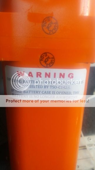

Hi Tom,
you should find it etched (melted) into the battery case, which is the large section with the big "warning" label attached. There's no need to open the case to see it.
I've got an expired one in my hangar. I'll check it out today to confirm

And the new "warning label" about replacing the battery is new - it wasn't there when I bought mine several years ago, I guess that's a reaction to the thread here on VAF about where to find replacement batteries for that unit.
