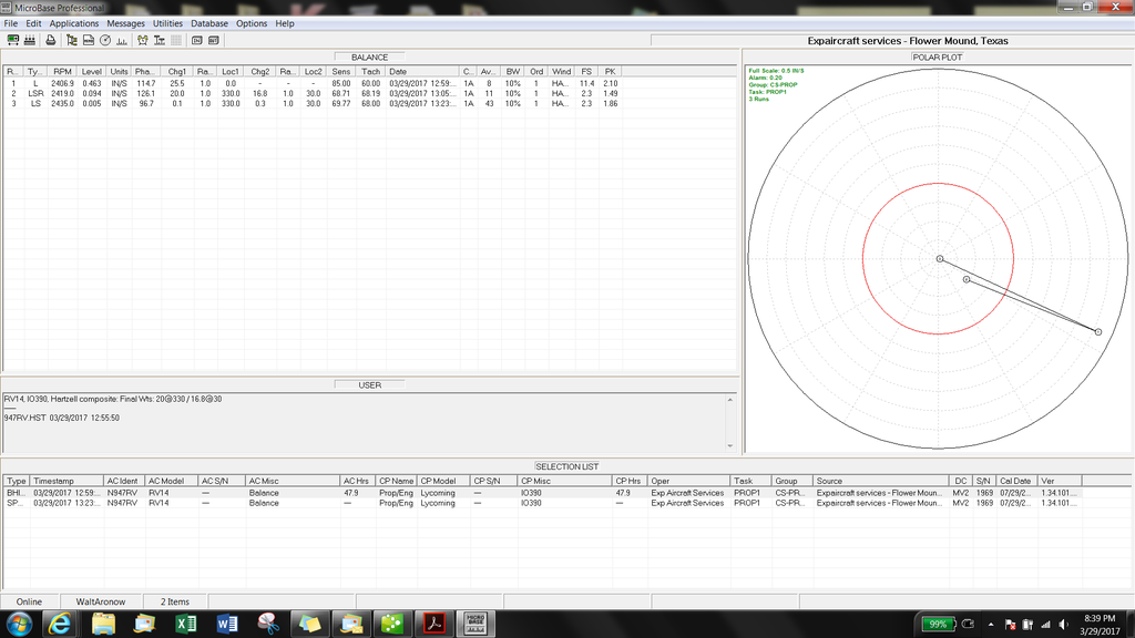

Just thought I'd post a quick view of another prop balance, this one on a RV14 with a new IO390 and Hartzell composite, as usual owner didn't notice any vibration but thought it would be good to check it while he was in the neighborhood.
Not sure if all the numbers will be visiable but the red circle represents the upper limit of 0.2 IPS. This one started off at 0.463 IPS (more than twice the upper limit) with a final result of 0.005 IPS on the 3rd run.
Do yourself and your equipment a favor, get er done.

Wow! Great results. Where are you mounting the weights? Starter ring gear or spinner back plate?

I use the starter ring gear when available (like it is on our RV's) to avoiding having to drill holes in the spinner back plate plus it's also much easier than R&R the spinner multiple times.
The 0.005 this one ended up at is unusually low and should not be considered a "bench mark" for balancing. My typical goal is 0.05 IPS or less which is half the recommended after balance limit of 0.1 IPS.
I believe the 390 with its counterbalanced crank combined with the Hartzell composite prop contributed to the excellent results. The spectrum analysis also showed lower than average vib readings.
