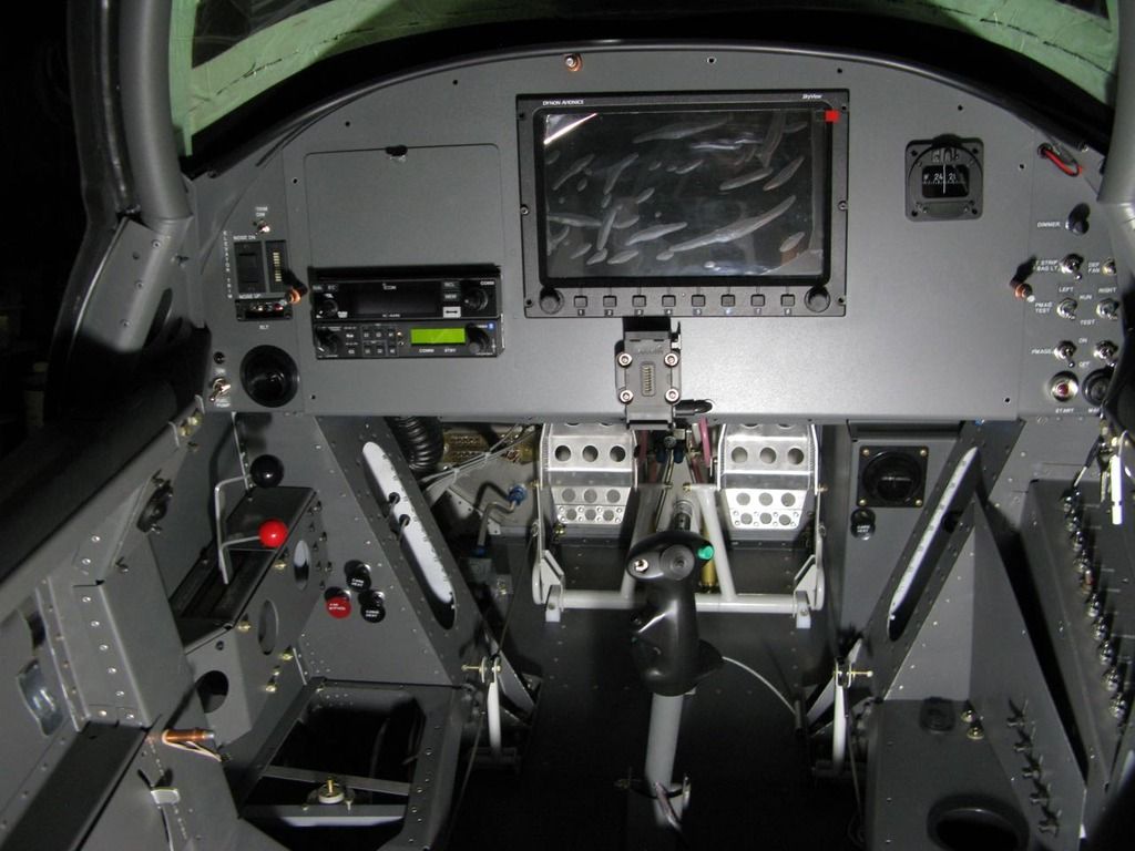

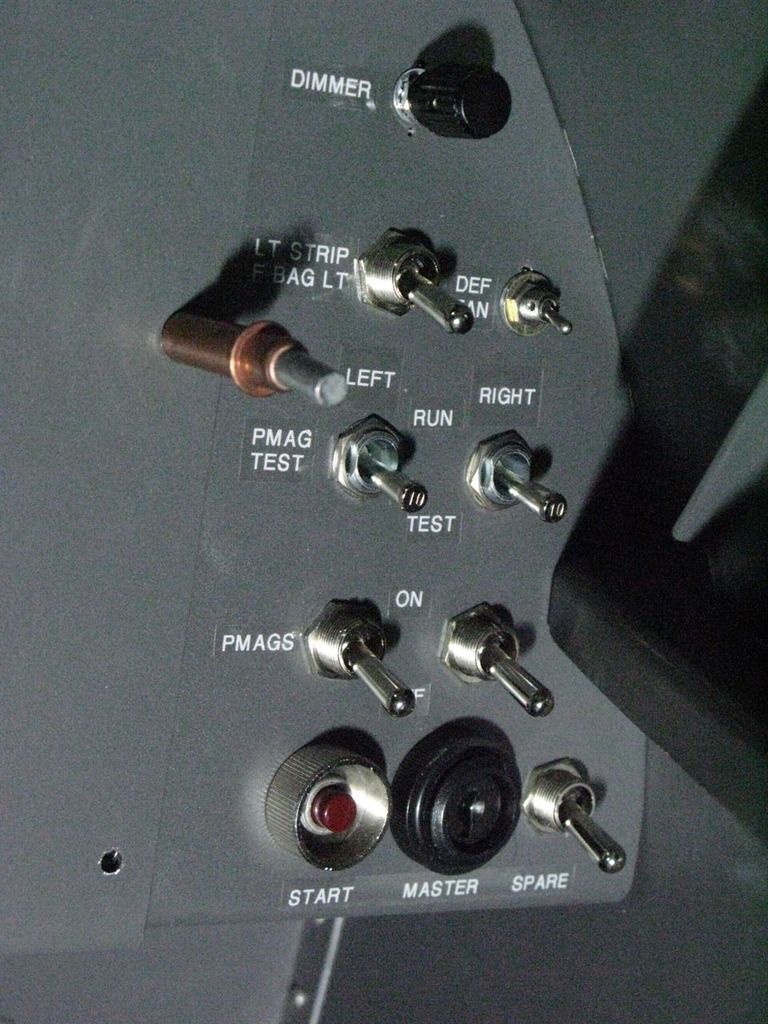

Just a data point
Tremclad Textured rattle can
4th season wearing well, photos are when built
applied before assembly
applies easily, can spray over remodelled parts without detection
dries very quickly
cleans easily
