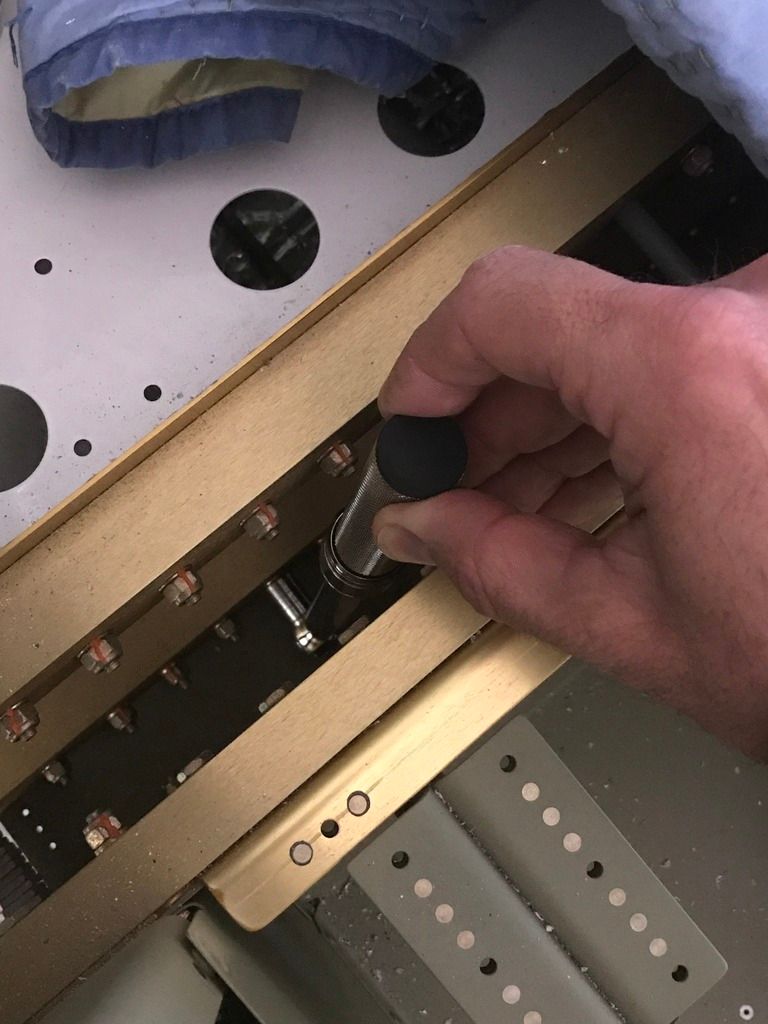

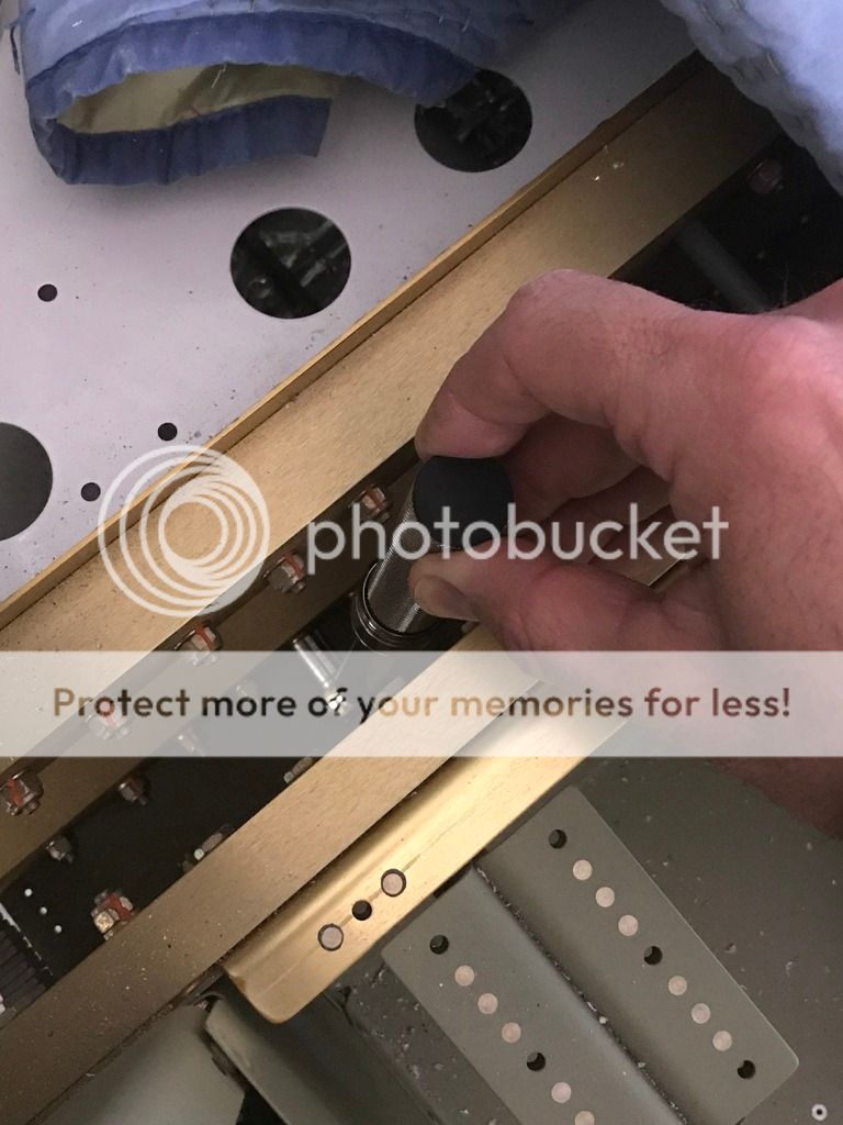

I have the CDI wrench from Cleaveland and it just fit over the nuts down in the spar:
Assuming you don't want to purchase another wrench just to fit, as Todd said, sometimes you just have to torque the bolt. I may be misreading your statement above, but if you can't get a wrench on the nut (in order to torque the bolt) how did you even get the nut started? Now I'm a skinny guy, but I remember cramming my (bloody) hands down there as far as I could more times than I could count. Who didn't love section 29!

My Craftsman click wrench with a short socket did not want to fit over the bolt heads. A set of cheap sockets I keep in my truck for emergencies provided a socket that was just short enough but I carefully ground about another 1/8" to make it easier to get over the nut. When the nut was hand tight, I pushed it flat to the spar to get the socket over it and then pushed the bolt back before tightening, though I wasn't really worried about 'drawing' the bolt into position. I did worry a little bit that grinding might have removed the temper of the socket but there's so little torque on these nuts it really wasn't a problem.

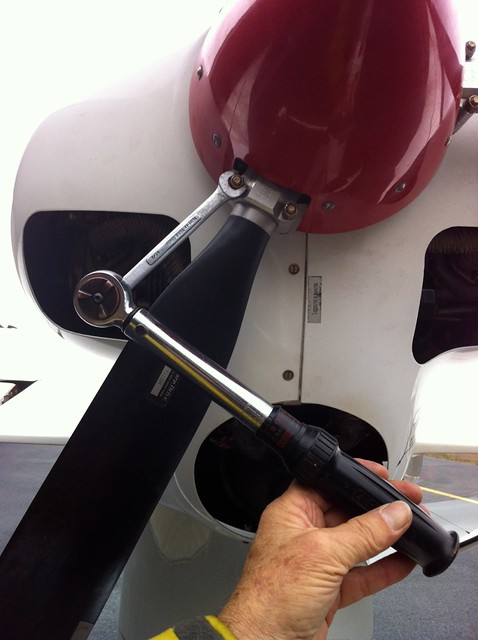

I sometimes take advantage of the fact that if your "extension" can be maneuvered to be 90?, no math is necessary.
Shown here as an illustration, though those prop clamp bolts are easily accessible with a normal socket.
A spring scale and a box end wrench can also work, though if you can't on it pull at 12" (for ft lbs) some math is involved.
