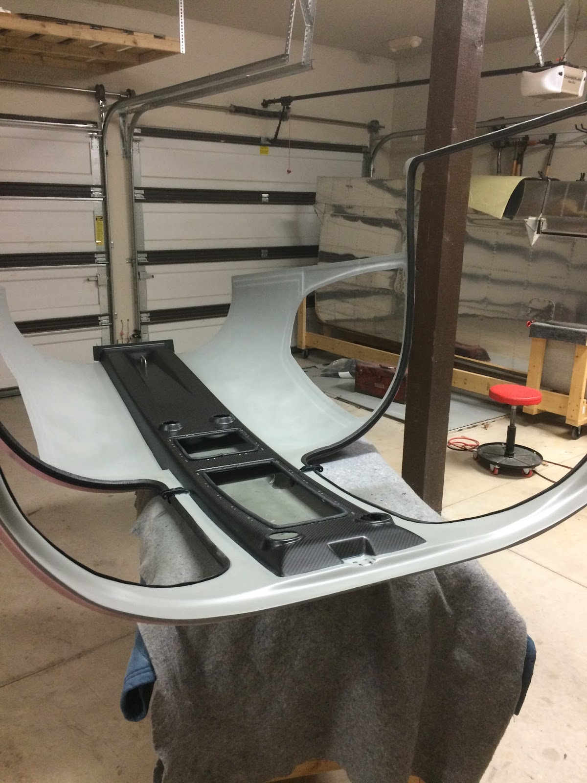

I'm working on my doors right now assuming that I'll micro and paint the interior side of them. I also plan on using the aerosport headliner which covers the back end of the cabin top.
This got me thinking that maybe I can cover everything with some type of headliner fabric. I may be simplifying it but wouldn't some contact cement allow me to just cover everything? I'm sure I could find some edging as well to finish the edge.
Would be interested to see someone else who has done similar.

Good morning! Yes I had planned to use that, but it doesn't cover the front area and they don't have anything for doors. Wasn't sure what others have done in regards to finishing the entire cabin top and doors with some type of material.

Justin if you are using one of the Aerosport Overhead console all you need to
do up front is finish of the cabin top and blend it into the Overhead console.
See the picture attached. Finish the cabin top inside really nice. You can also leave the Over console Carbon showing and still blend and have a nice transition line.

Geoff I actually already have your overhead console installed and I left it carbon fiber.
I assume I'll finish the doors in much of the same manner. But that gets me back to what people have done on the doors, seems like you could just 3M adhesive some matching headliner fabric to the door and put some type of trim on it and have a nice finished look.

Justin, is that paint or primer inside your cabin top? If paint, how'd you accomplish the semi-gloss look?

I would not put any covering on the door. I would paint it the same as your cabin top finish with a slight semigloss texture. It takes a little more time to
finish the inside door skin but the results are really nice.Here is a picture of
my doors finished to match the cabin top. If using the McMaster Carr door seals your inside door surface needs to seal off on the door.
