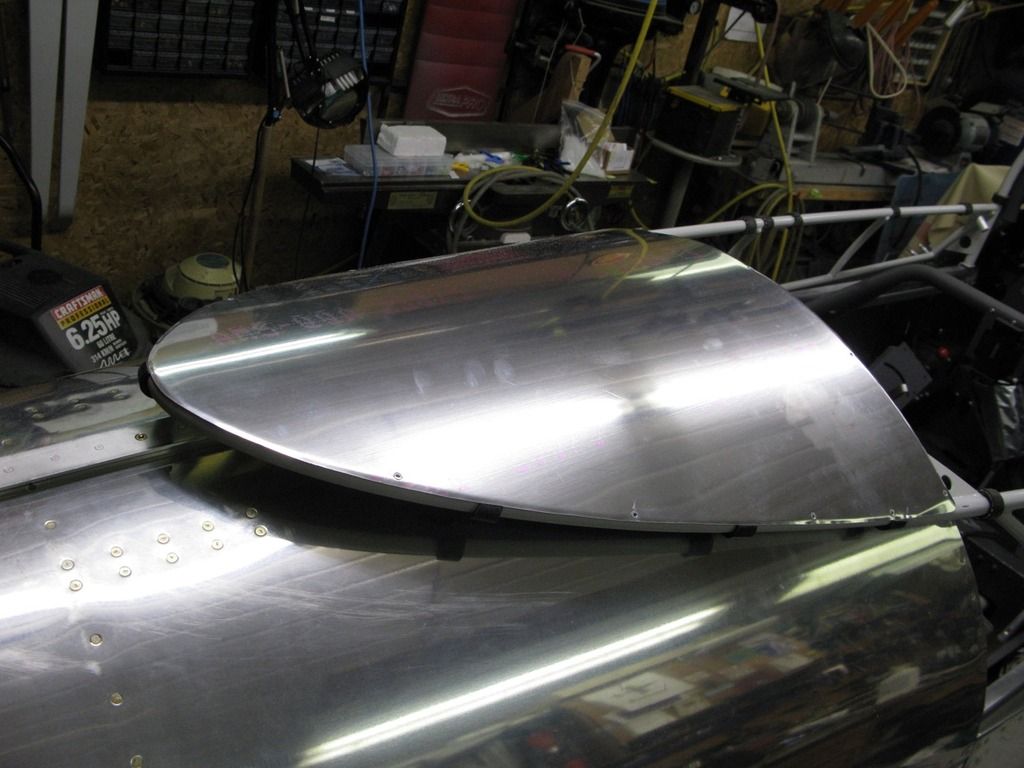

Default Probably as good as it gets...
This is what I did... for what it's worth.
"Hat shelf" idea shamelessly borrowed...

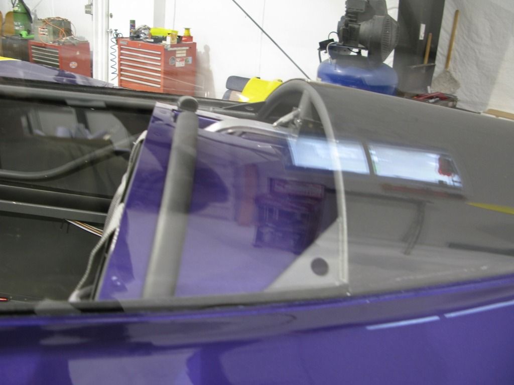

D weatherstrip seal
Wife said air coming from rear track "well" was like a cold hair dryer on the back of her neck so added "RV" (the other kind) foam in front of D weatherstrip. Complaints stopped.
Light rain was ok but heavy rain would migrate forward along canopy rail. Added fuzzy velcro around lower perimeter of canopy skirt. No more water... Sorry no pics.
