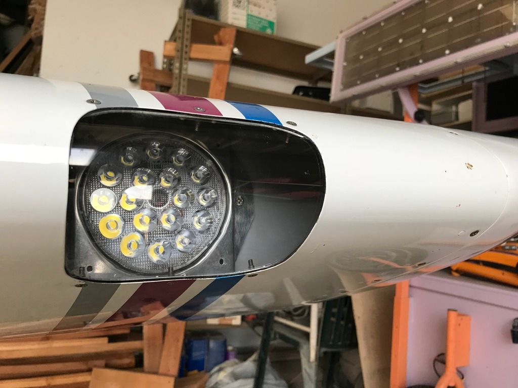

Old 12-17-2017, 12:05 PM
chuckwn's Avatar
chuckwn chuckwn is offline
Join Date: Jul 2007
Location: Petaluma, CA
Posts: 261
Default PAR36 LED Work Light installation Report
Purchased two of these from Amazon (choose the “spot” option, not the “flood”):
http://a.co/irxrxDP
and two of these from Duckworks:
"Round Light Retainer Bracket (holds Round 4" 'PAR-36' Lamps)" $15 each + $8 shipping (ouch!)
http://duckworksav.com/Individuals.html#Retainers
I had 55W halogen Duckworks rectangular reflectors installed. I removed the reflectors and cut the rectangles out to fit the new round PAR36 lights.
The "Retainer Bracket" hole diameter had to be enlarged by about 3/16" to fit over the PAR36 LED lights .
The good news is the Duckworks retainer bracket attach holes are in the same spot as the rectangular reflector retaining holes!!
I tested for radio interference and discovered one of the two lights breaks the squelch in the 125.00 - 128.00 VHF frequency range.
Having had RF interference issues with Aveo Engineering nav lights and been supplied free RF chokes to put on the wires by their very helpful customer service representative (Damian), I contacted them and obtained the part number for the chokes.
[Würth Elektronik] 74270062 Ferrite core
https://octopart.com/search?q=74270062
See the second picture for how to install the chokes on the wires of the lights.
The result is VERY bright noise free installation. The LED lights draw 1.2 amps each and are MUCH brighter than the 55W halogens that drew 5 amps each. This has been a huge safety and power efficiency improvement. The only negative is the lights weigh about 10 oz. each vs maybe 2 oz. each for the halogen lights and reflectors.
Highly recommend this modification!!!
Chuck Newman
Petaluma, CA
RV-8 N828RV
