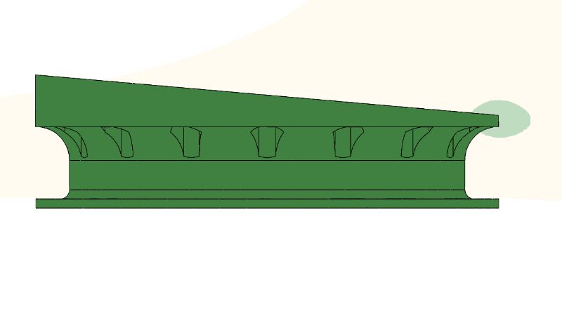

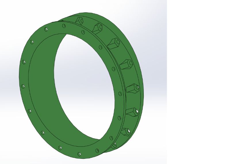

I thought I would try one of these landing lights but same for me, I couldn't determine how to mount it so I thought I would try a couple designs and print from plastic.
Here's the first design printing now. I'm trying to move the lens as far fwd as possible to be able to point the light properly past the leading edge of the fairing. the mount can be rotated at install to achieve the proper angle.... if it fits. rotate the black and grey for angle. it is going to look goofy. any other ideas appreciated.

  #14
Old 02-16-2017, 04:05 AM
Steve Melton's Avatar
Steve Melton Steve Melton is online now
Join Date: Apr 2011
Location: Cincinnati, OH
Posts: 2,788
Default mount idea
prototype of the base. coarse print for speed. a couple more parts to design and print yet. not bad for a couple hours work. obviously, you don't need all the holes for mounting. they are for clocking options to achieve angle. yet to be determined, will it fit? I didn't have a model of the wingtip lens so this will be trial and error. base weight = 0.19 lb
Steve Melton
Cincinnati, OH
www.rvplasticparts.com

  #20
Old 02-16-2017, 07:55 PM
Join Date: Apr 2011
Posts: 2,788
Default no way
no way this is going to fit. the 9 wing tips are different than the 4. well, I'll still finish the design. maybe someone else can use it sometime. this is what happens when you don't have a model of the design space, or just take some simple measurements. duh.
