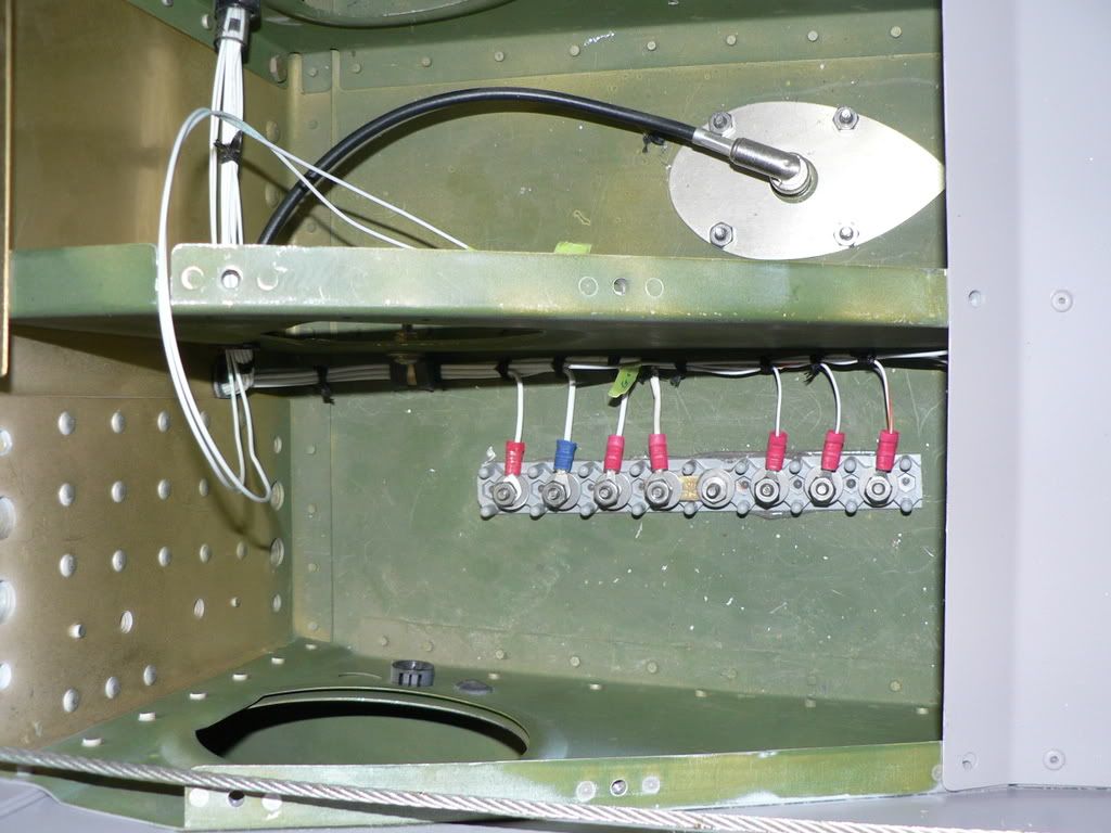

  #20
Old 09-06-2008, 07:11 PM
SportAvServ SportAvServ is offline
Join Date: Jul 2006
Location: Ione, California
Posts: 254
Default Wing/fuse wires
This is another way, a terminal strip prosealed to the floor.
