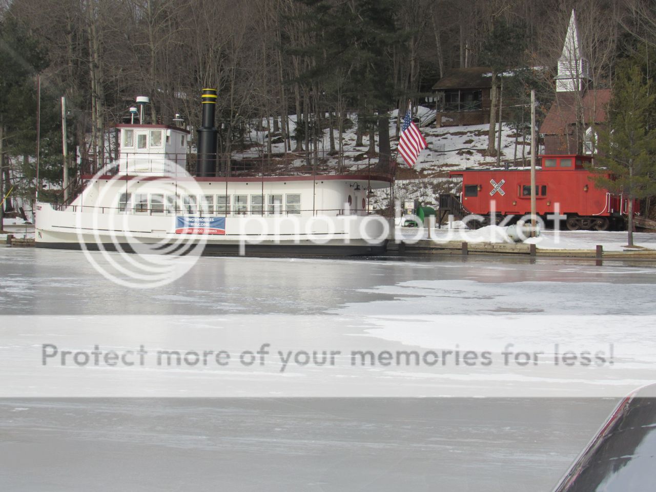

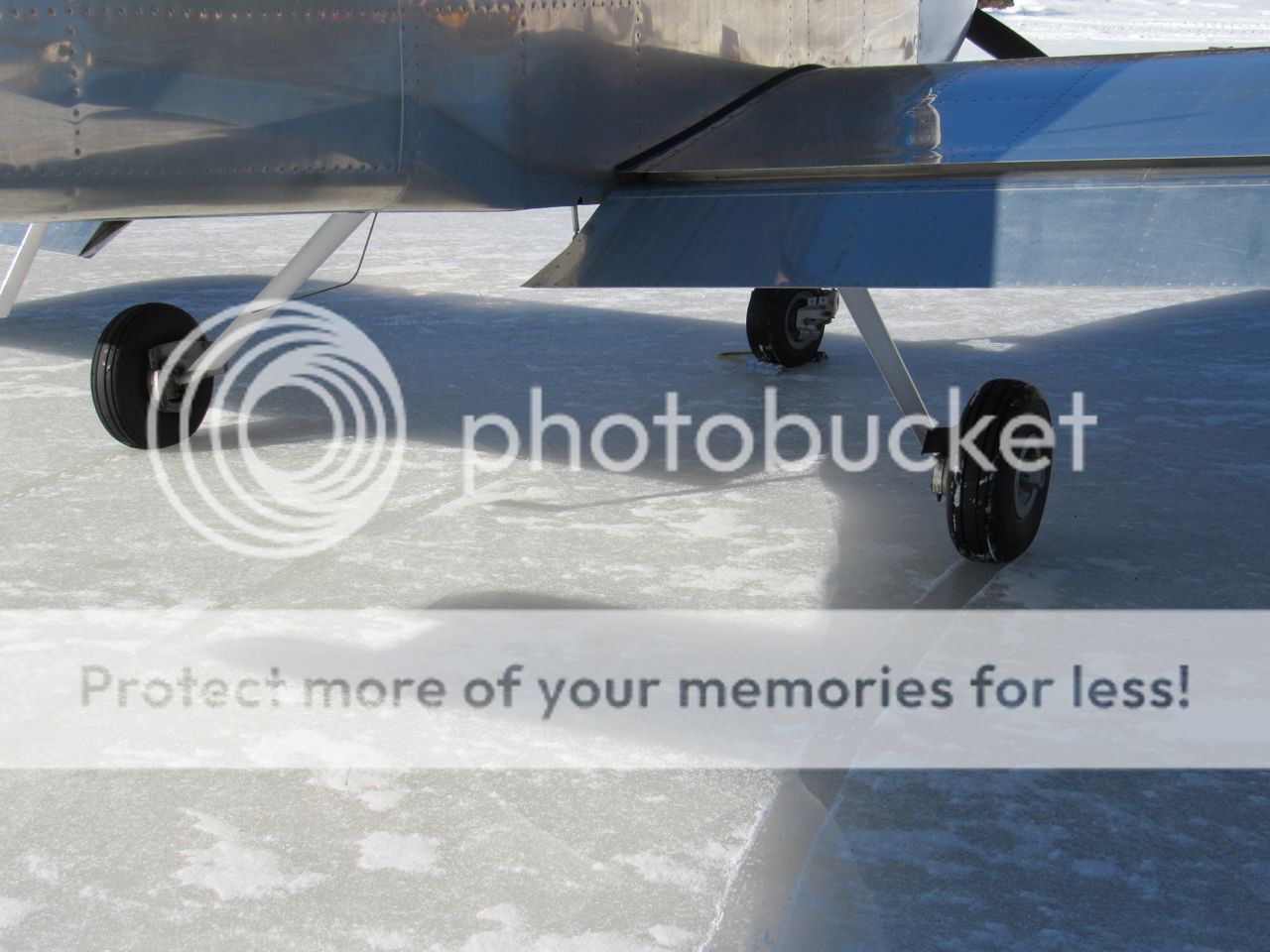

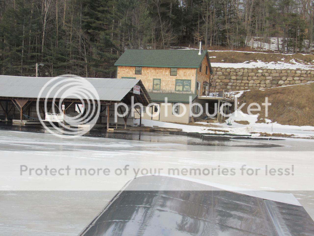

Nothing wrong with floating when cold. Go Float! No wake!

Go Float!
So Vlad, how was your braking action on that lake? LOL! ...and what about directional control? Did you ever have to step out of the aircraft and push the tail around to aim the plane where you wanted to go?

Braking action zero directional control minimum minimorum. I did push the aircraft to aim in right direction.
