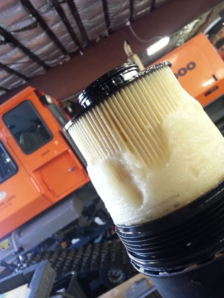

This is #2 Diesel just a little past cloudy Ever since the government changed to the ultra low sulfur fuel we have experienced serious problems with this new fuel. Back before they changed the chemistry the #2 would cloud around -15 F now we get complete filter blockage at 5 F. I hope that our LL or auto 91 does not do anything like this.
