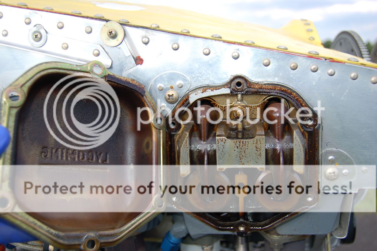

Ryan for first 1,300 hours I used AeroShell and was happy. Then I changed cork gaskets for silicone and noticed some brown residue. I asked here and there was a qualified opinion it was caused by the oil I use.
A bit off-topic, but...how'd you get that brown gunk off? I started to change mine to silicone gaskets, but the first one was such a pain in the butt to get rid of the brown gook, I stopped with just one done. Would like to change them all, but need a better method to clean the flange and covers.

Remember they were doing this on radials that could leak many gallons of oil into a cylinder and create a hydraulic lock. That is the reason for the pull through. Just start the Lycoming opposed designs.
Oh - gunk? Either hot (very hot) water rich with Wisk, or something with methylene chloride, like paint remover or carb cleaner. The latter is ok for aluminum, the Wisk is not.
