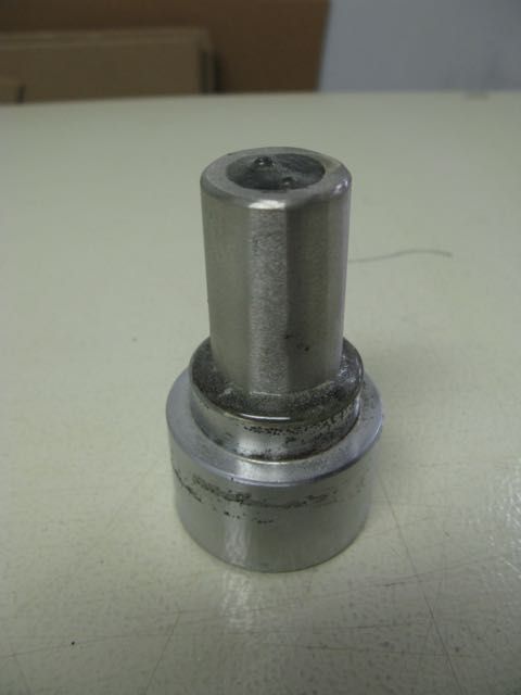

One of mine...
- Mazda MPV brake slave piston, faced on a friend's lathe
- "Who knows" piston pin from my Dad's junk box
- Handfull of AA buckshot
- Epoxy
Result, the best back riveting buck I own...
