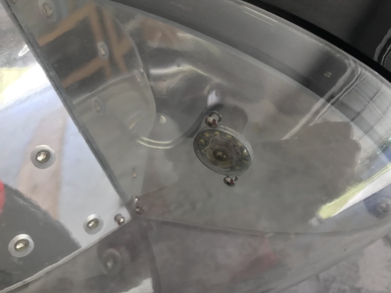

Item 1: My wingtip strobes seem to be generating too much heat for the clear plastic covers. Kind of hard to see in the attached photo, but the lens has actually gotten wavy to the touch right over the strobe.
Given that I'm a CBWLS (cheap bast-rd with limited skills), what's the easiest/cheapest fix for this?

Don't turn the lights on until you are in the air. That is the way to not melt them. Order new lenses from fan not a big deal to cut to fit with good scissors.

I recently saw a -6 model and the builder drilled an intake hole and an exit hole in the lens. Only figure I could muster was for cooling or fogging?

And you can move strobe back a couple of inches.
Can make plated out of .032 and polish

Yep. I would make a new reflector for the strobe and move it back so that it isn't so close to the lens. Test it first with the messed up lens then if it is ok order a new lens. 1/8" reflective acrylic is available for Home Depot so it should be pretty simple to make a new one using the old one as a template.

I've built the same exact nav/strobe setup, and it also melted my wingtip lens within just a couple of hours of use. I had a QuickStrobe ballast in each wingtip, and i think the pattern in that has the strobe on for way longer than a regular aviation pattern does, overheating the bulb.
I ripped out the strobes and replaced them with Feniex Cannon LED strobes. The are $70 each, very bright, put out no radio noise and fit in the same hole.

I'd leave it and see how it goes..
Mine had a bit of softening/ curve early on,...but no further issue in over 500 hrs.
Unless you are going for perfect,...buy avgas instead

if the lights meet the brightness spec., the reflectors are pointless. By having these under the lights, they move the heat source closer to the lens, which is likely your problem. Just an uneducated opinion.
